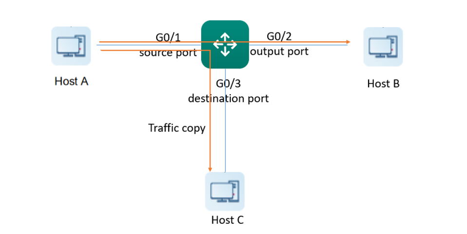

Requirements:
Copy the packets of the mirror port (source port) to the observation port (destination port) so that the complete packets can be obtained for network analysis.
Topology:
Configuration steps:
Hostname> enable
Hostname# configure terminal
Hostname(config)# monitor session 1 source int gigabitEthernet0/1
Hostname(config)# monitor session 1 destination int gigabit Ethernet 0/3

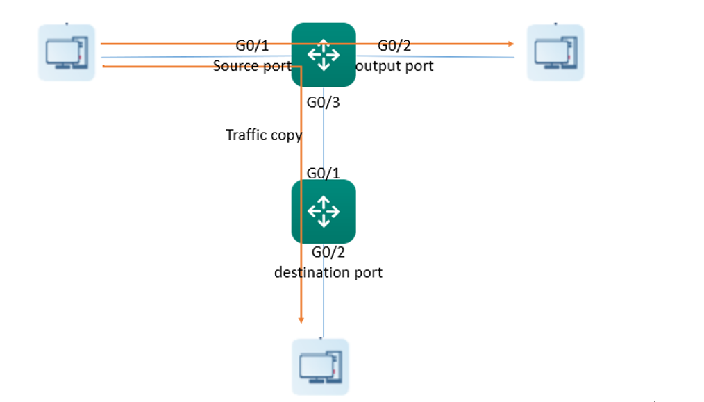

Topology:
Configurationsteps:
Source device:
switchA# configure terminal
switchA(config)# vlan 100
switchA(config-vlan)# remote-span    --->set avlan for RSPAN
switchA(config-vlan)# exit
switchA(config)# monitor session 3remote-source   --->setthis device as source device
switchA(config)# monitor session 3 source interfacegigabitethernet 0/1 both    ---->monitorboth input & output traffic from G0/1
switchA(config)# monitor session 3 destinationremote vlan 100 interface gigabitethernet 0/3   ---->send out the traffic copy from G0/3
Destination device:
switchB# configure
switchB(config)# interface gigabitethernet 0/1
Switch C(config-if)# switchport mode trunk
Switch C(config-if)#exi
switchB(config)# vlan 100
switchB(config-vlan)# remote-span   --->set avlan for RSPAN
switchB(config-vlan)# exit
switchB(config)# monitor session 3remote-destination   --->set thisdevice as destination device
switchB(config)# monitor session 3 destination remote vlan 100 interface gigabitethernet 0/2   ---->received the traffic copy from G0/2

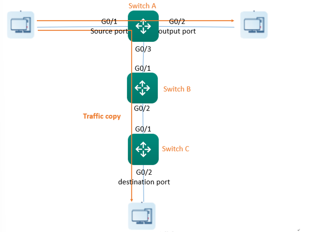

Topology:
Configurationsteps:
Source device(Switch A):
Switch A# configure terminal
Switch A(config)# vlan 100
Switch A(config-vlan)# remote-span    --->set a vlan for RSPAN
Switch A(config-vlan)# exit
Switch A(config)# monitor session 3remote-source   --->set this device as source device
Switch A(config)# monitor session 3 sourceinterface gigabitethernet 0/1 both    ---->monitorboth input & output traffic from G0/1
Switch A(config)# monitor session 3 destinationremote vlan 100 interface gigabitethernet 0/3    ---->send out the traffic copy from G0/3
Middle device(Switch B)
Switch B# configure
Switch B(config)# vlan 100
Switch B(config-vlan)# remote-span   --->set a vlanfor RSPAN
Switch B(config-vlan)# exit
Switch B(config)# interface gigabitethernet 0/1
Switch B(config-if)# switchport mode trunk
Switch B(config)# interface gigabitethernet 0/2
Destination device(Switch C):
Switch C# configure
Switch C(config)# vlan 100
Switch C(config-vlan)# remote-span   ---set a vlan for RSPAN
Switch C(config-vlan)# exit
Switch C(config)# monitor session 3remote-destination   --->set thisdevice as destination device
Switch C(config)# monitor session 3 destinationremote vlan 100 interface gigabitethernet 0/2 ---->receivedthe traffic copy from G0/2

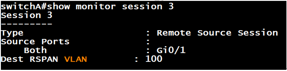

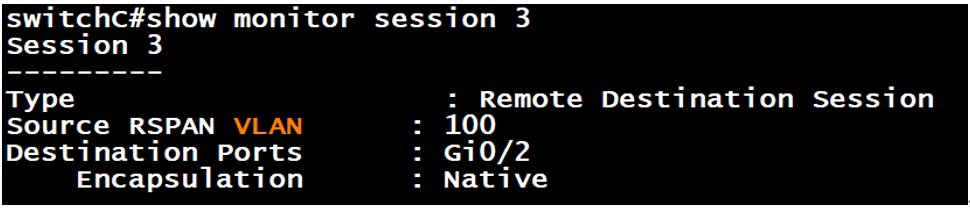

Verification:
Command: show monitor session 3
