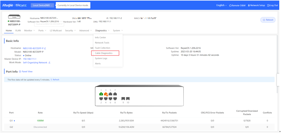

1. Click Diagnostics--->Cable Diagnostics

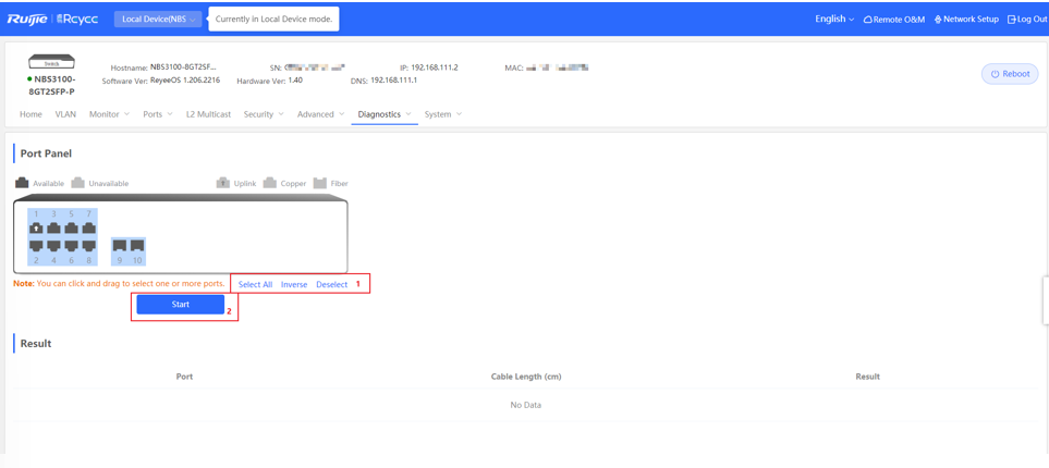

2. Select the port you want to check and click Start

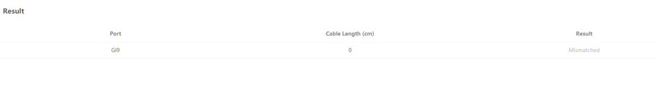

3. The result will display as follows:
