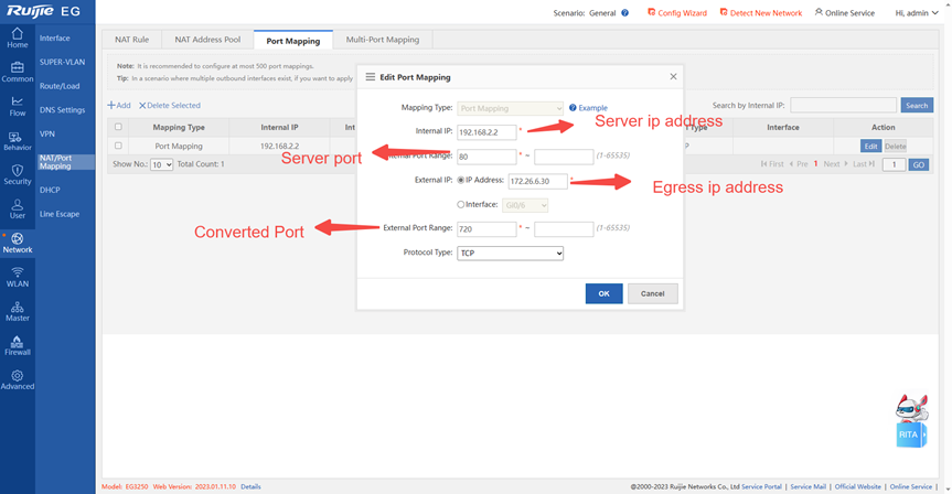

2.Check that Port Mapping is configured correctly

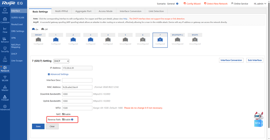

4.If EG is configured with Load balancing, check if' Reverse Path 'is enabled.

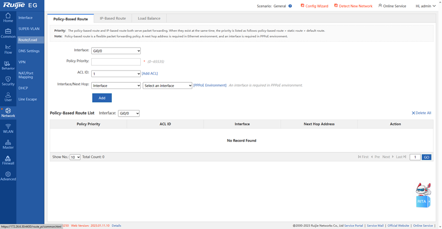

5.Check if EG is configured with Policy-Based Route
