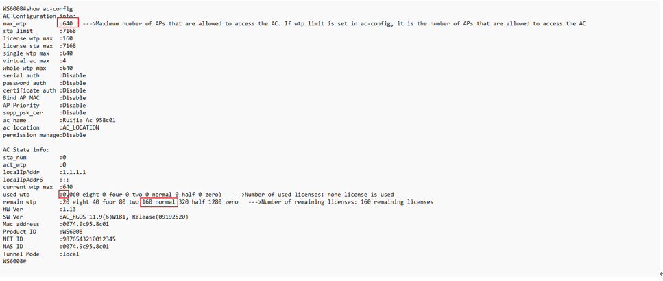

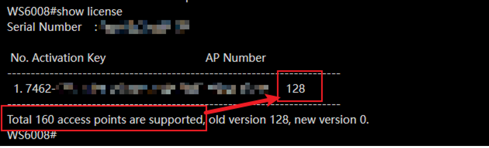

2). The ac license is insufficient.
RuijieAC#show ac-config
RuijieAC#show license

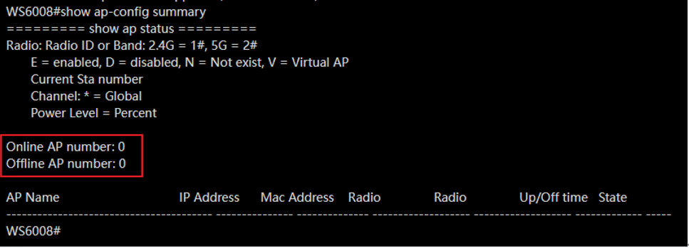

RuijieAC#show ap-config summary

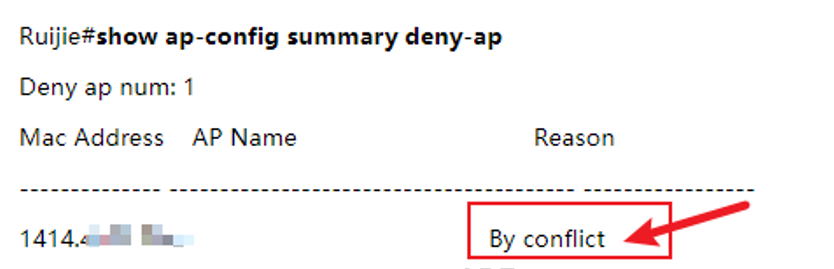

RuijieAC#show ap-config summary deny-ap
  By bind-ap-mac    AP-MAC binding rejected. The MAC whitelist  bind-ap-mac function was enabled on the AC, but the MAC address of the ap was  not in the AP-config
  By wtp-limit    The number of online APs reaches the upper limit
  By conflict    The AP name and MAC address conflict. The AP name  and MAC address of another AP are already online or configured on the AC
