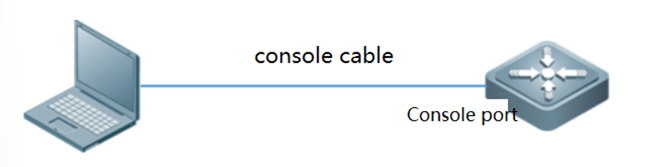

1.Networking topology

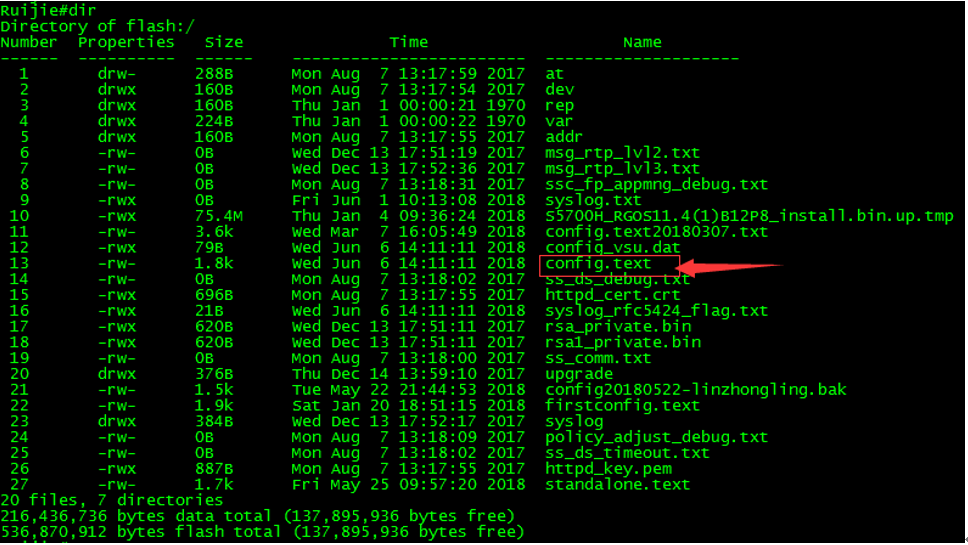

(3) Log in to the switch and run the following command on the switch to back up the configuration of the switch to the USB flash drive:
Ruijie#copy flash:config.text usb0:config.text------> No spaces between usb0 and config.text

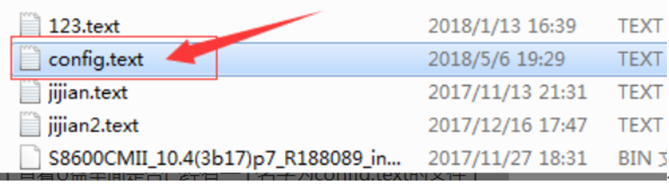

3.Plug the USB flash drive into your computer to see if there is already a file named config.text on the USB flash drive
