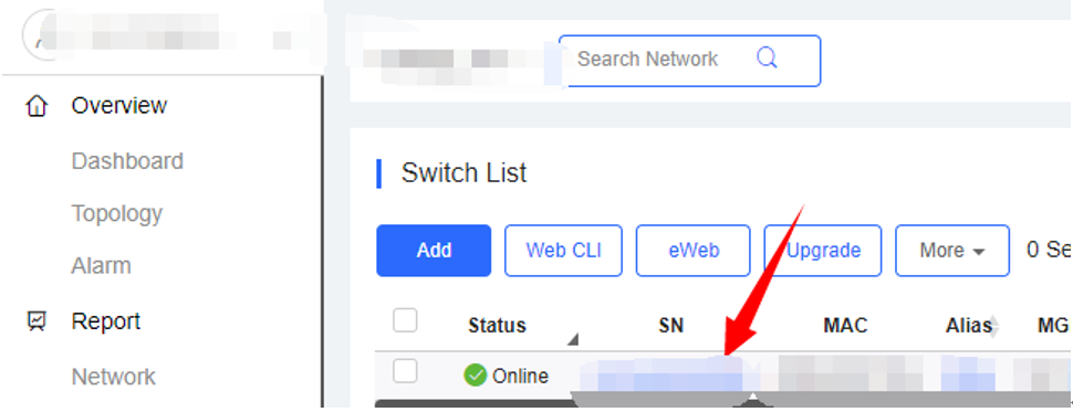

In the Cloud.Click the SN of the device

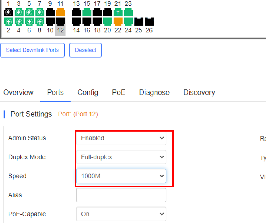

Select Ports and change the status to Enabled, Speed to 10M (maximum Speed), Duplex to full Duplex

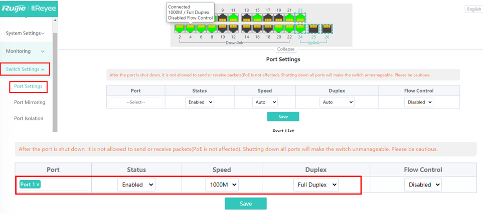

3.In the web interface you can Click[Switch Setting]-->[Port Setting]
Select Ports and change the status to Enabled, Speed to 10M(maximum Speed), Duplex to full Duplex.
Note: Data transmission distance is limited by the transmission medium. When your transmission speed is higher, the signal frequency is relatively high. In different media produced at different intensity of interference, it may become a barrier to data transmission, thereby affecting the bit error rate of data! In other words, the lower the speed, the longer the transmission distance
