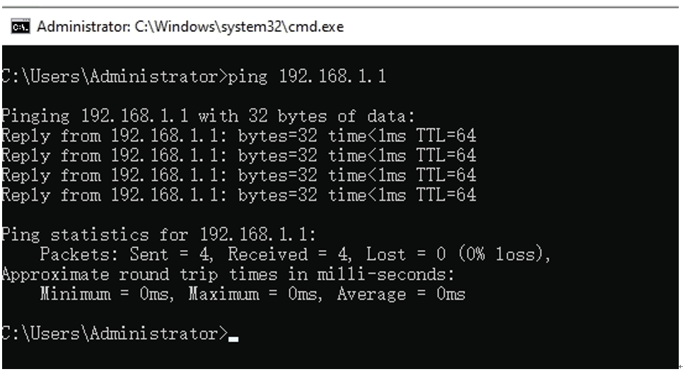

Step3: Run the ping command to test the connectivity between the PC and the device.
If you can not ping through 192.168.1.1, you cancheck the device's actual lan interface ip address via CLI: Ruijie#show ip int bri or you canrestore the device to factory settings to try to login again.

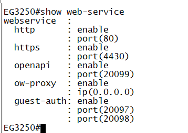

Step4: Check if the device's web service isenabled.
Console to the EG and type these commands: Ruijie#show web-service to check:
If the web service is disabled, you can use this command to enable it:
Ruijie>enable
Ruijie#conft
Ruijie(config)#enableservice web-server all
Ruijie(config)#end
Ruijie#wr  //save the config
By default, the http port is 80, https port is 443.
