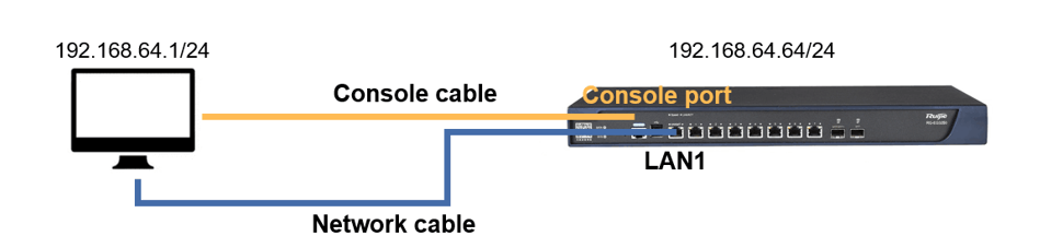

Topology:
Configuration Steps:
Step1: Connect the console cable to the switch. Connect Ethernet cable to the first copper port or MGMT port (physical port doesn't link up until data transfer starts, you also can not check ping connectivity during this process)

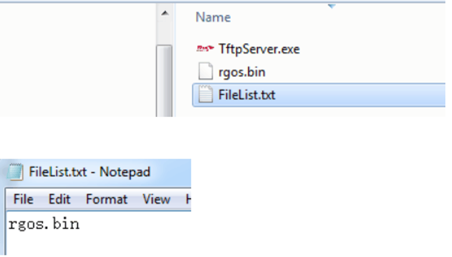

Step 2: Assign IP address 192.168.64.1 to laptop, enable TFTP Server and also prepare the firmware, put on the firmware with the same folder with tftp server.

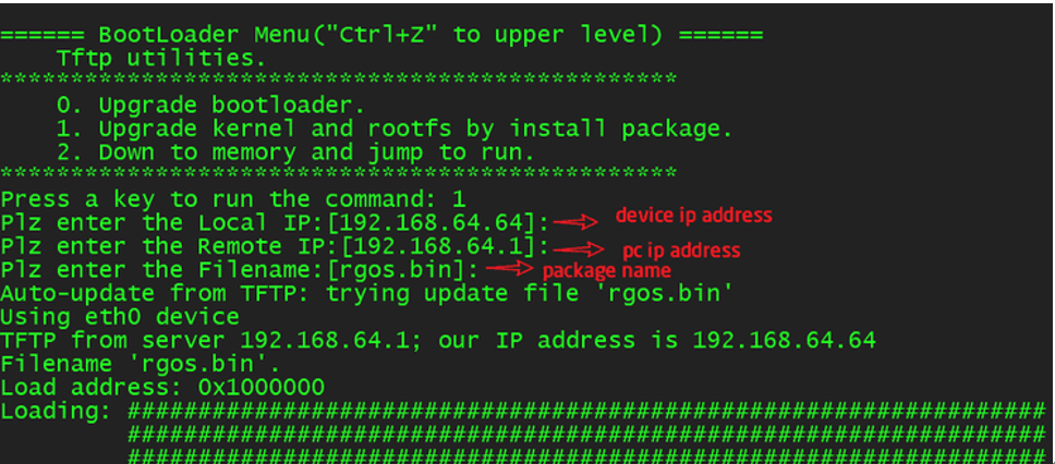

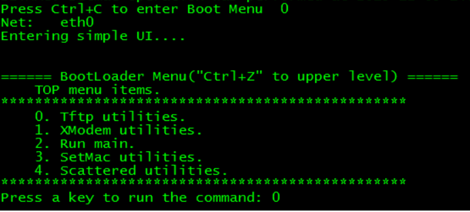

Step3: Console in device, restart devices, press "CTRL + C" when system prompts, enter BOOT Mode, Input 0
Step 4: Input 1, then upgrade firmware with the following steps.

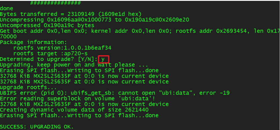

Step 5: Input "yes"

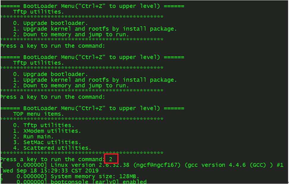

Step 6: Press "CTRL+Z" to return to upper level, then choose "2" to run main.
