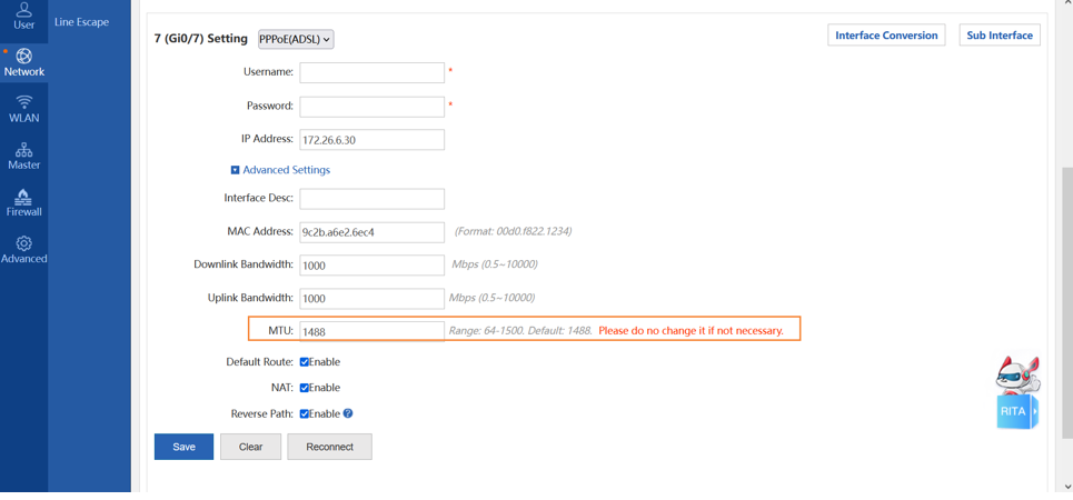

Step3: Check whether the interface MTU configuration is correct. The mtu value of the pppoe client needs to be 1492 or less.

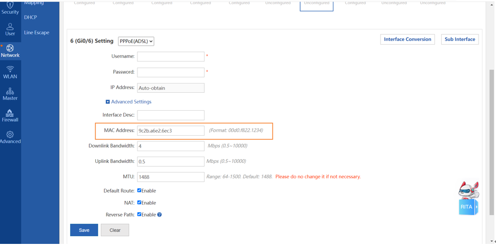

Step5: If the PC can dial up normally, you can try to modify the mac address of the dial-up interface to the mac address of the PC network adapter to test whether it is normal.
