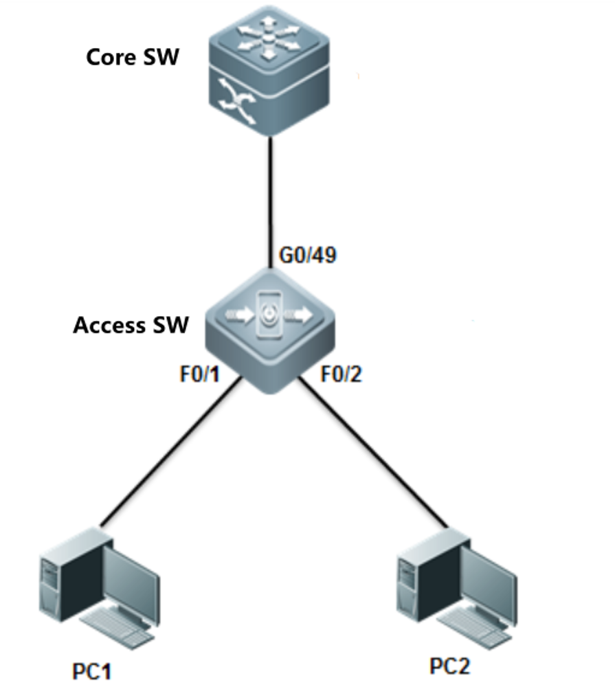

a) Requirement
The access switch connects PCs which use static IP addresses. In order to prevent ARP spoofing, the ARP spoofing problem is solved by using the port IP+MAC binding form + ARP-check solution.
b) Network Topology
Configuration Tips:
1. Enable the port security function on the port of the access switch connected to the user, and set IP+MAC binding.
2. Enable the arp-check function on the port of the access switch connecting to the user
c) Configuration

2) Configuration on the Access SW
Ruijie>enable
Ruijie#configure terminal
Ruijie(config)#interface fastEthernet 0/1
Ruijie(config-if-FastEthernet 0/1)#switchportport-security binding 0021.CCCF.6F70 vlan10 192.168.1.1   ------> bind the PC belonging tovlan10 with mac address 0021.CCCF.6F70 and ip address 192.168.1.1 to the first100 megabit interface of the switch
Ruijie(config-if-FastEthernet 0/1)#switchportport-security  ------>Enable portsecurity
Ruijie(config-if-FastEthernet 0/1)#arp-check                       ------>Enablearp-check
Ruijie(config-if-FastEthernet 0/1)#exit
Ruijie#write
The requirement is that port Fa0/2 can only connectcomputers with an ip address of 192.168.1.2 and a mac address of0023.5abd.1975, both of which are considered non-compliant with the securityrules if either does not match.
Ruijie(config)#interfac fastEthernet 0/2
Ruijie(config-if-FastEthernet 0/2)# switchportport-security binding 0023.5abd.1975 vlan10 192.168.1.2  ------> bind the PC belonging tovlan10 with mac address 0023.5abd.1975 and ip address 192.168.1.2 to the second100 megabit interface of the switch
Ruijie(config-if-FastEthernet 0/2)#switchportport-security  ------>Enable portsecurity
Ruijie(config-if-FastEthernet 0/2)#arp-check                        ------>Enablearp-check
Ruijie#write

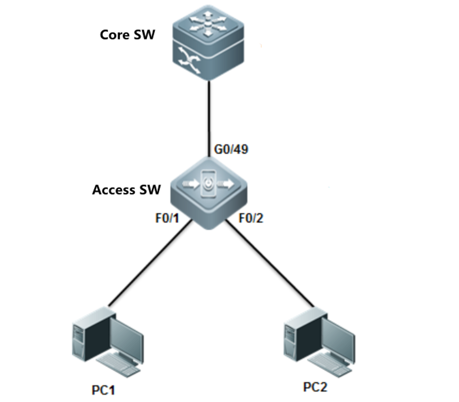

The access switch connects PCs which use static IP addresses. In order to prevent ARP spoofing, the ARP spoofing problem is solved by using the Global IP+MAC binding form + ARP-check solution.
Configuration Tips:
1.IP+MAC binding in global mode on the access switch
2.Enable trusted ports on the access switch
3.Enable address-bind function globally
4.Enable the arp-check function on the port of theaccess switch connecting to the user
Configuration:
Ruijie>enable
Ruijie(config)#address-bind 192.168.1.1 0021.cccf.6f70  ------> bind the user with IP 192.168.1.1mac 0021.cccf.6f70
Ruijie(config)#address-bind 192.168.1.20023.5abd.1975 ------> bind user with IP 192.168.1.2 mac 0023.5abd.1975
Ruijie(config)#address-bind uplink gigabitEthernet0/25   ------> sets port 25 as theuplink port, which is unchecked and all user messages can pass through
Ruijie(config)#address-bind install------>Enable this function globally
Ruijie(config)#interface range fastEthernet 0/1-2
Ruijie(config-if-range)#arp-check------> Enable ARP-Checkunder the interface
Ruijie(config-if-range)#end
Ruijie#write
Notes:
1.After the address-bind install is enabled globally, all matched users can access the Internet, but users who are not bound or incorrectly matched cannot access the external network.
2.For users who are bound, the corresponding IPv6 messages cannot be passed, so if you want to allow users who are bound correctly to use IPv6 addresses for access at the same time, then you need to enable IPv6 mode on the switch as compatible mode:
Ruijie(config)#address-bind ipv6-mode?
  compatible IPv6 compatible mode ------>Compatible mode, bound MAC users can access the external network with IPv6 addresses
  loose IPv6loose mode ------>loose mode, all IPv6 addresses can access the IPv6 network
  strict IPv6 strict mode (default: strict)------>Strict mode: the switch works in this mode by default, even if the correct user is bound, the IPv6 address cannot be used to access the external network
Ruijie(config)#address-bind ipv6-modecompatible
3.The bound user has nothing to do with theinterface. The same switch is not controlled by the interface, as long as thebinding is correct, the user can access the Internet on any port of thatswitch.
