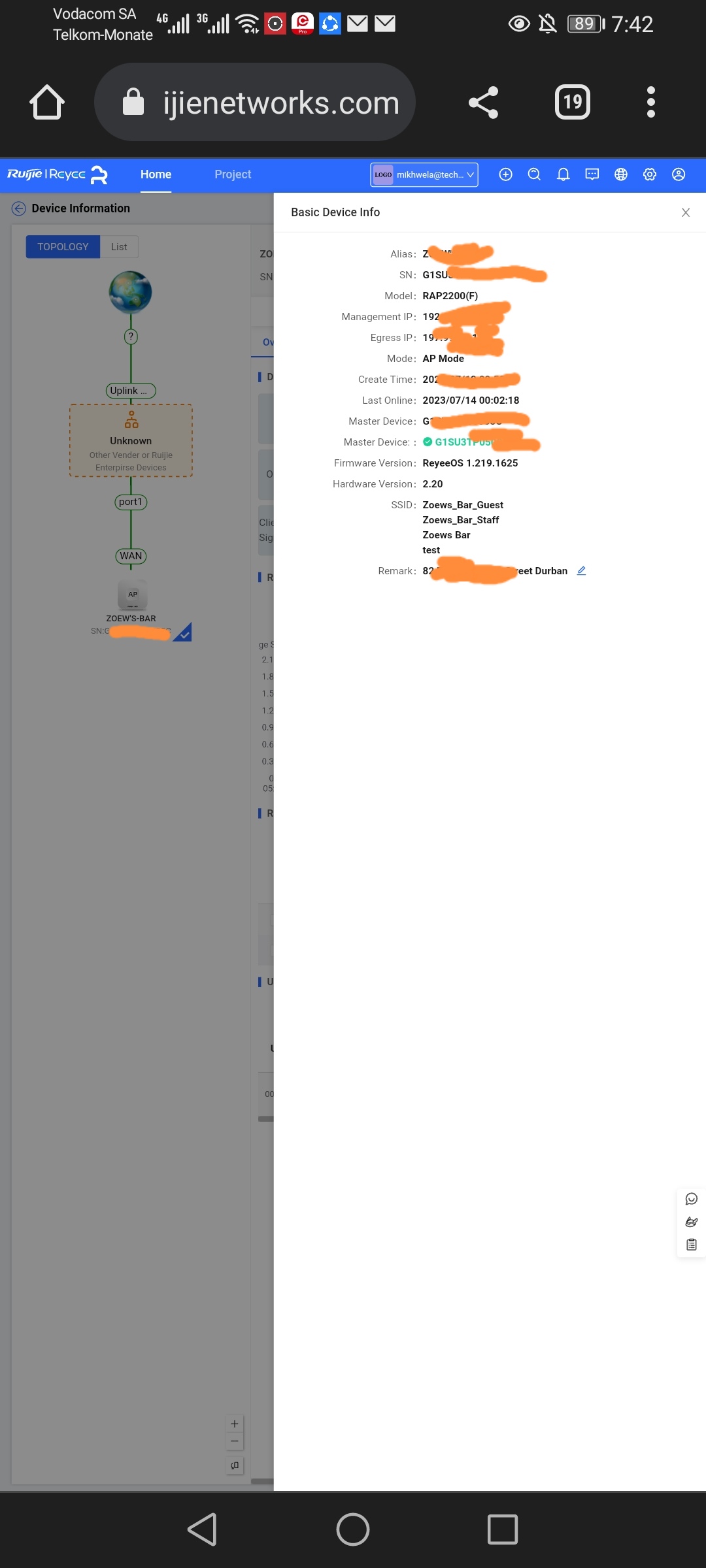

Thanks for your reply, this is what I have (see screenshot below) I believe I did upgrade the firmware. What steps would I need to follow to get the captive portal up and running in my case?

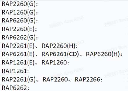

Dear sir,
Sorry, due to the hardware limitation, RAP2200(F)  can not support captive portal
Only these models of APs can support captive portal
Best Regards,
Ross
