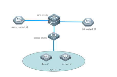

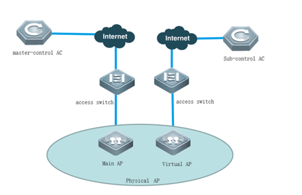

3.Networking mode
Two networking modes are available based on the usage of the AP upper link: single AP upper link and double AP upper link.
(1) Single uplink: The Master-control AC and branch Sub-control AC use the same uplink port for communication (the aggregation port must be the same uplink port).
(2) Dual-uplink: The Master-control AC and sub-control AC use different upper interfaces for communication (that is, different upper links).
