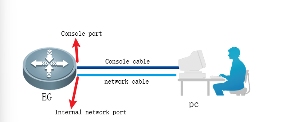

(1) Topology
(2) configuration points

a. Use the configuration cable to connect the console port of the device and use the network cable to connect the inner network port of the EG device.

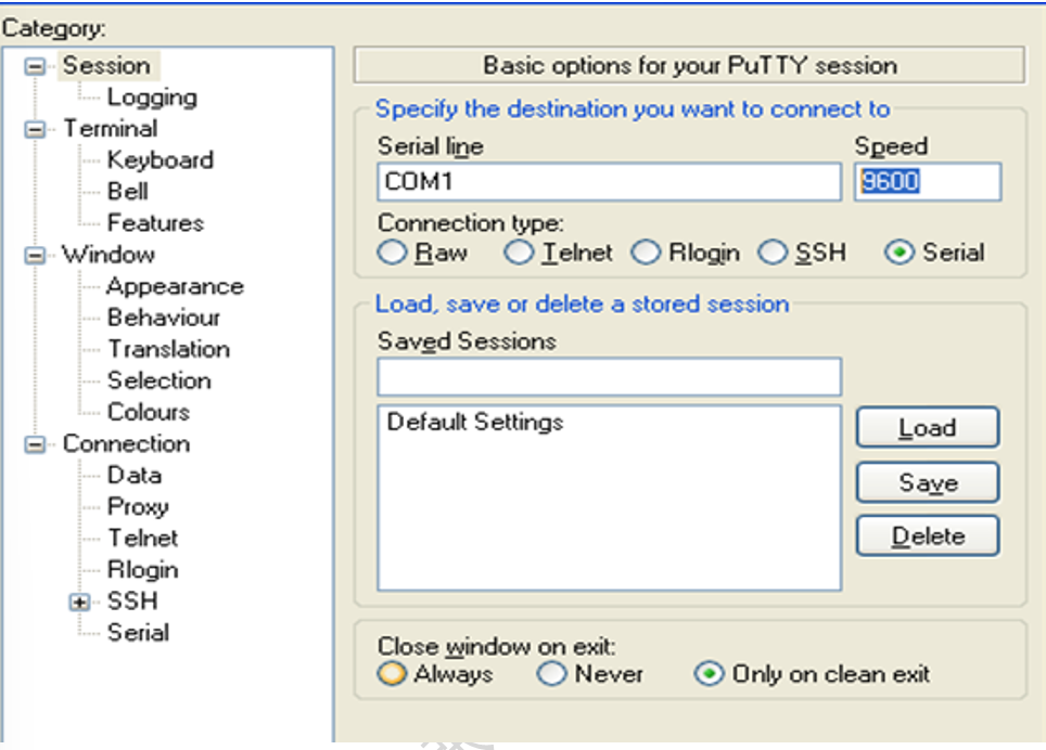

b. Use software Putty to configure network devices.
Open your software Putty, set the baud rate to 9600.

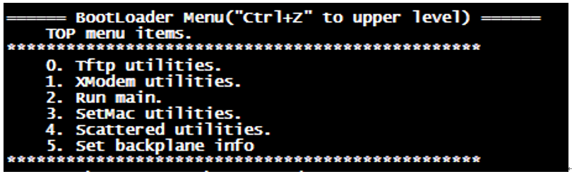

c. Power off and on the device, then press Ctrl + C repeatedly in the Putty interface until the main menu is displayed. As shown in the picture:
Then press Ctrl+Q to enter the uboot command line, enter main_config_password_clear, enter the device and restart the system.

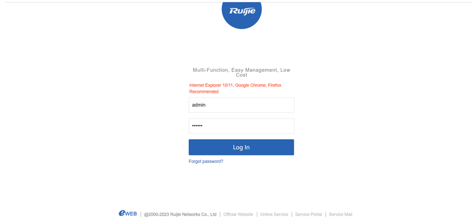

d. Log in with the new password to view, as shown below:
