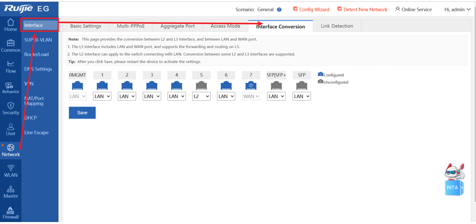

How to modify the working mode of Reyee AP? Reply
3364 0 2023-7-19 13:52:55
The following interface conversion modification takes effect only after the device is restarted. Therefore, you are advised to avoid peak hours.
EG#show sys-mode # Check whether the interface is a LAN or WAN interface.
EG3000XE-I
Configuration Router
