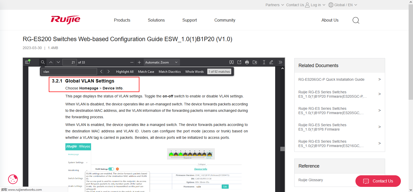

ES series switches can not support voice vlan function. But it can support configuring access port and add vlan tag on its port. You can refer to this guide to configure vlan on the switch on page 21: https://www.ruijienetworks.com/resources/preview/R-77156/
