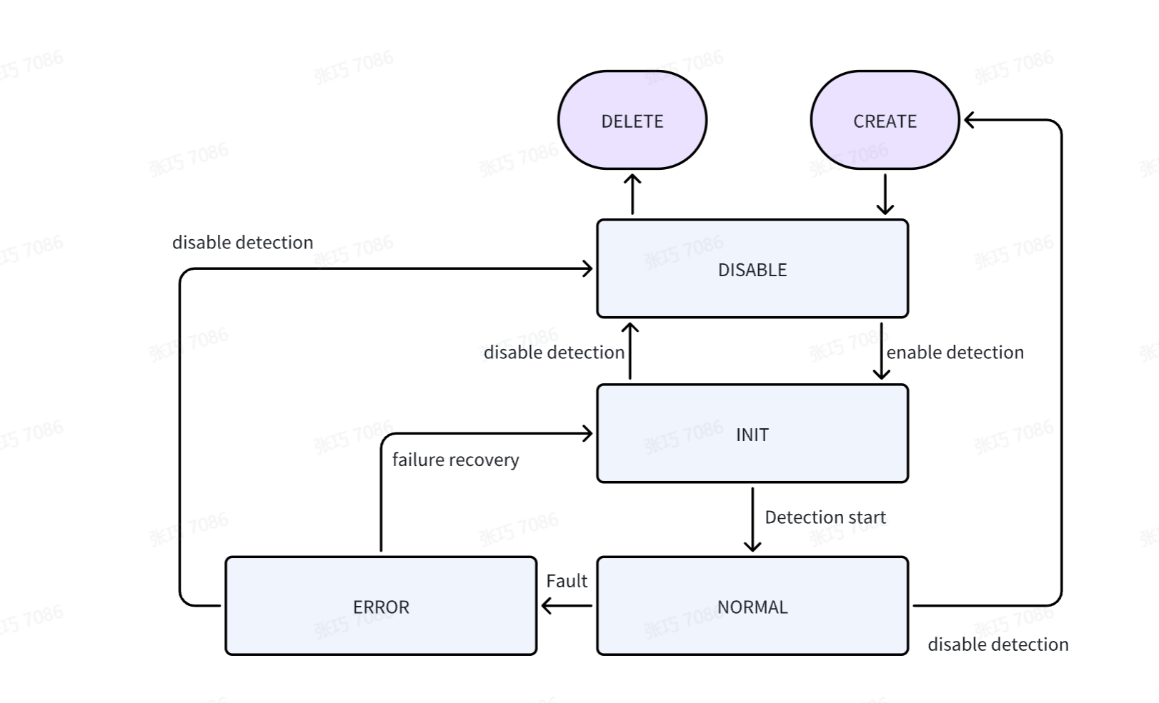

1.1.9 Detection principle
Generally, the Ethernet link detection mechanism only uses the physical connection status to detect link connectivity through automatic negotiation at the physical layer. However, this detection mechanism has certain limitations. In some cases, although the physical layer is connected and can work normally, the actual layer 2 link cannot communicate or is abnormal. RLDP uses detection packets, response packets, or loop packets to identify neighbor devices and detect link faults.
Figure 1-3 shows the RLDP detection logic.
Figure 1-3
Table 1-4 lists the four main states.
StateExplain
DISABLEAfter the function of an RLDP port is enabled, the port is in the DISABLE state. Unidirectional link detection, bidirectional link detection, and downlink loop detection are not enabled on the port. If the configuration is disabled in any state, the port is in the disabled state.
INITThe initial status of the RLDP protocol after it is enabled or after the fault is recovered is configured. In this case, unidirectional link detection, bidirectional link detection, or downlink loop detection is enabled on the port, and the corresponding processing mode is specified when a link fault occurs, or the RLDP recovers from a unidirectional fault, bidirectional fault, or loop fault.
NORMALRLDP enters the status after the detection is enabled. RLDP enters the status after the detection of downstream loops is enabled. RLDP enters the status after the detection of unidirectional or bidirectional links is enabled.
ERRORRLDP detects a fault. The port detects a unidirectional link fault or a bidirectional link fault. When a fault occurs, handle it according to the fault handling mode specified by the corresponding detection mode.
Table 1-4
