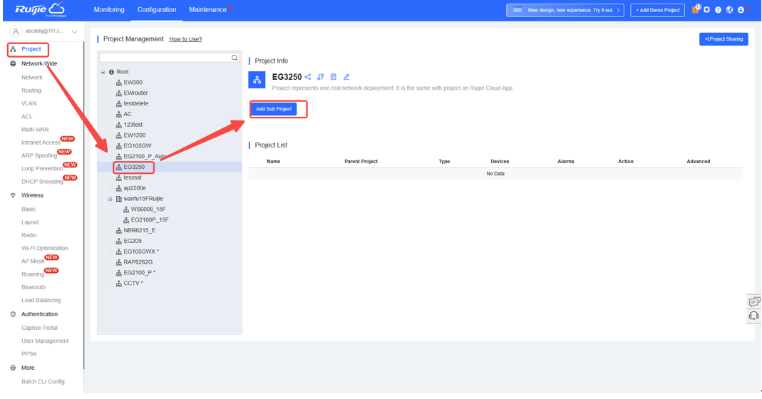

You can configure it according to the following steps.

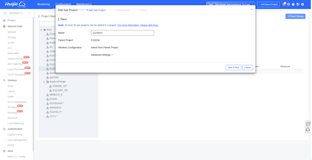

1.Create sub-project

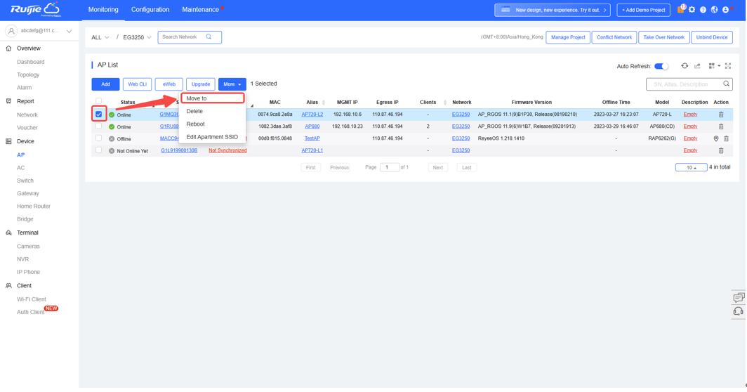

2. Move the specified AP to sub-project

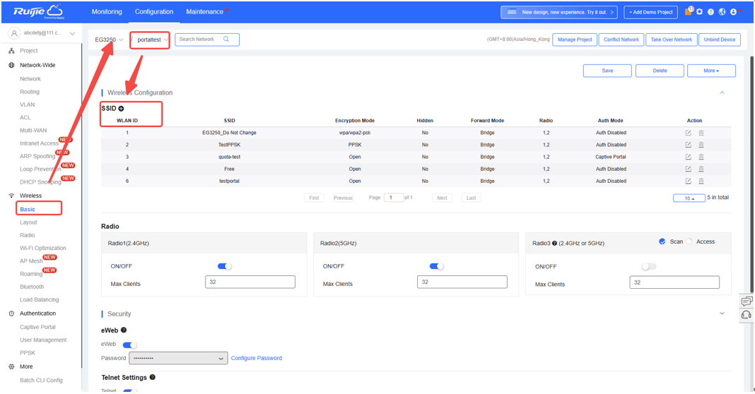

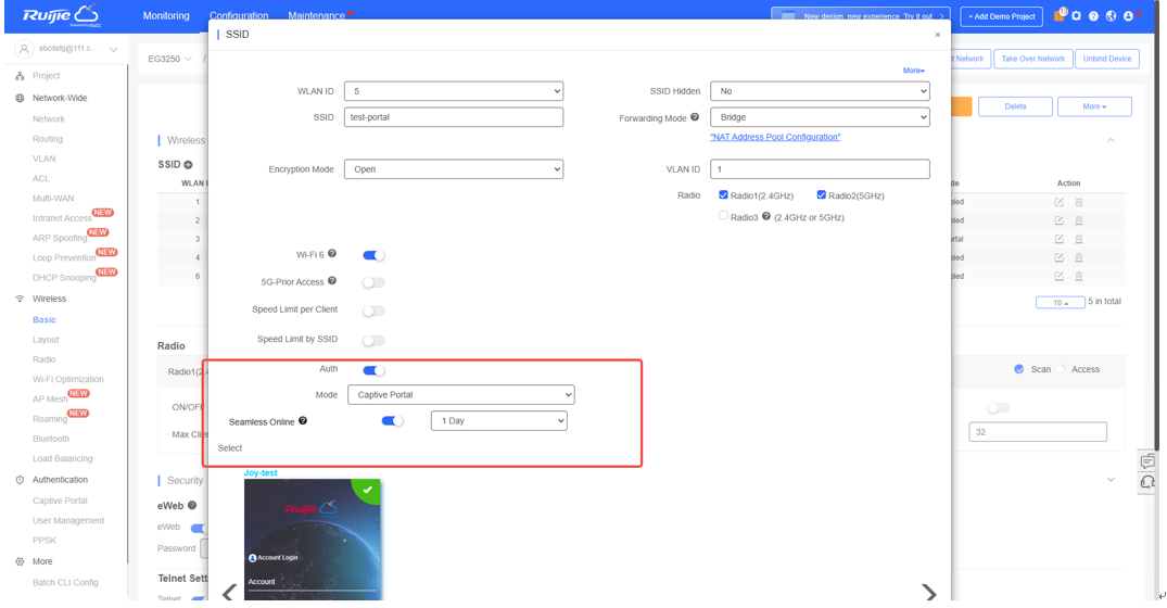

3.Then create the SSID of the portal in the sub-project. After the configuration is completed, only the AP in the sub-project will broadcast the SSID of the portal.
