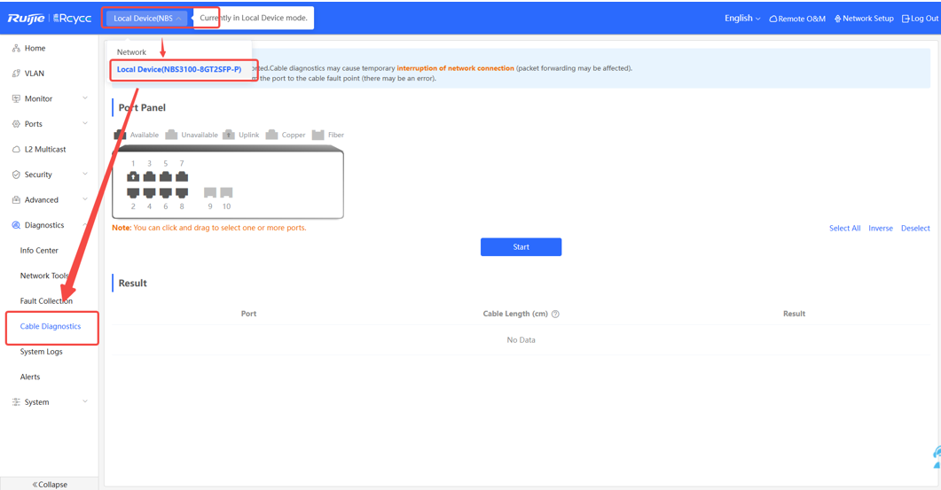

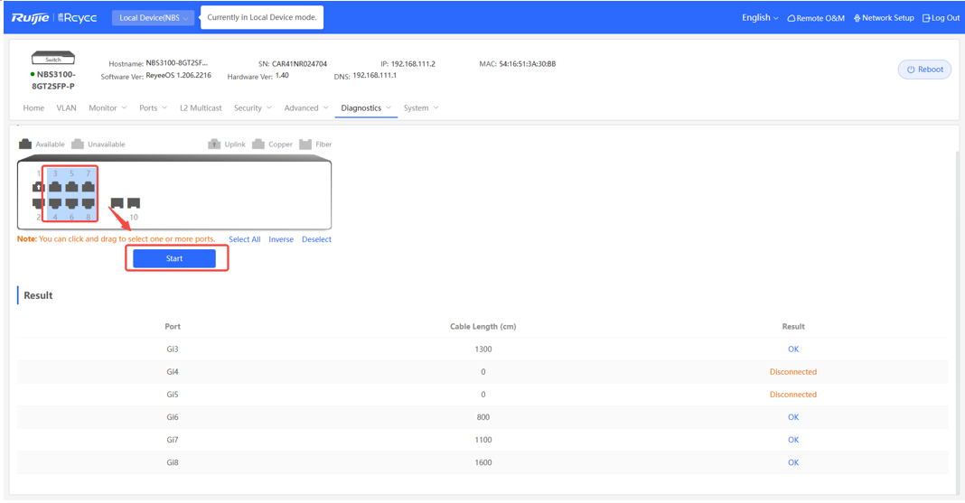

1. Click Local Device>Diagnostics>Cable Diagnostics
2. Select port and then click Start
