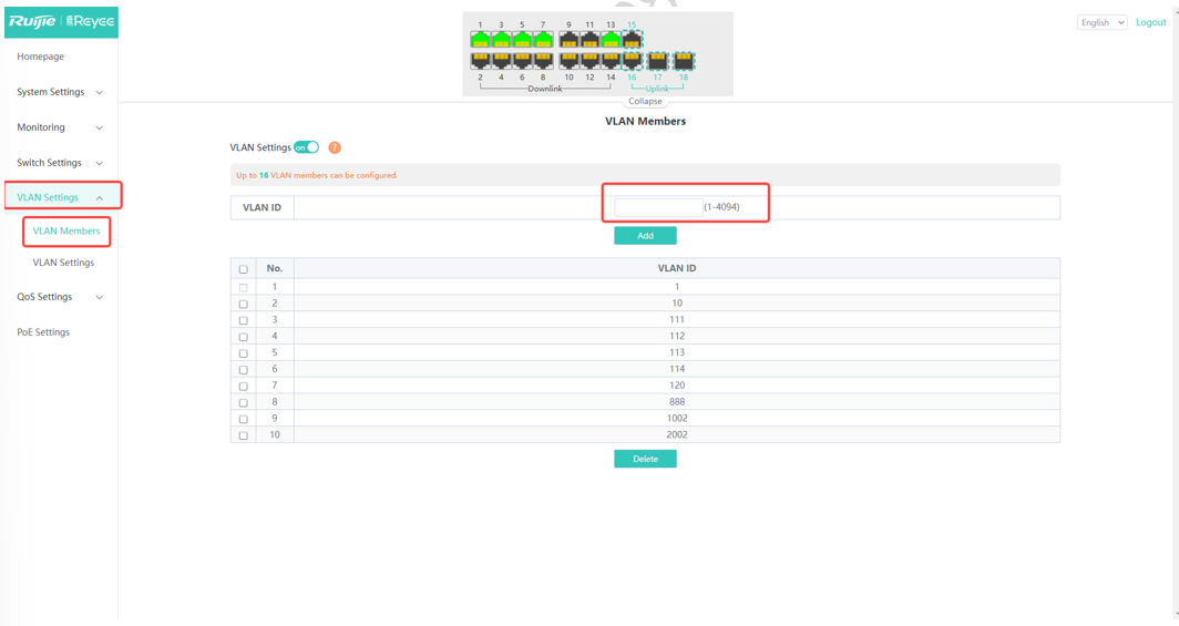

You can configure it according to the following steps.
Click 'VLAN Setting' > 'VLAN Members' > Enter VLAN ID > click 'Add'
