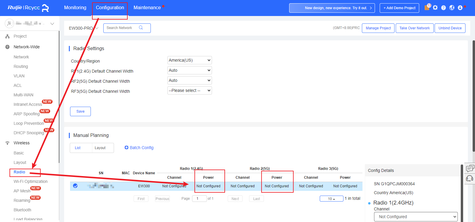

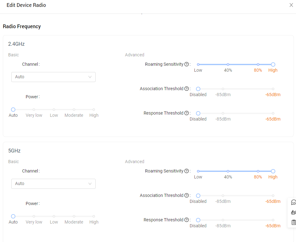

May I know the power of AP? You can adjust the power and check again.
0 2023-7-27 14:13:00 View all replies
GTAC-Micca replied at 2023-7-27 13:22
all was set to AUTO.
0 2023-7-27 14:27:42 View all replies
this settings work perfectly. I can now received signal
thanks for the help GTAC-Micca
