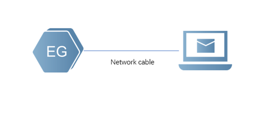

1.      Connect PC to EG with a network cable

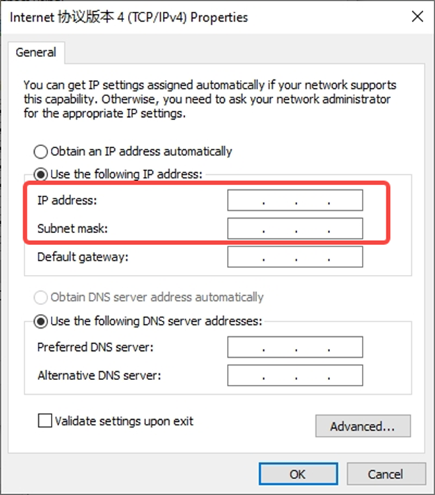

2.      Configure the  PC with the  same  network segment  IP (such as 192.168.1.2, the mask is 255.255.255.0)

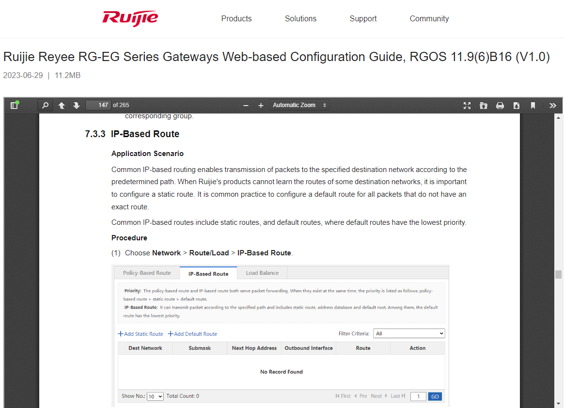

Can  LAN ports in EG perform routing, we are connecting EG to Ruijie L3 switch(Routed port). we are trying to connect one port from EG to Ruijie L3 (P 24) which has been configured as routing port. The dillema i am facing is while definiing WAN port for P2P with Ruijie L3 it prompts me for gateway IP address.
0 2023-8-28 09:22:53 View all replies
  replied at 2023-8-26 22:08
Can  LAN ports in EG perform routing, we are connecting EG to Ruijie L3 switch(Routed port). we ar ...
Dear sir,
Yes, the LAN ports can perform routing. You can refer to page 147 of the following link to a web-based configuration guide on how to configure static routes.
https://www.ruijienetworks.com/resources/preview/ruijie-reyee-rg-eg-series-gateways-web-based-configuration-guide-B16
