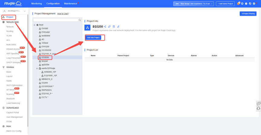

You can configure it according to the following steps

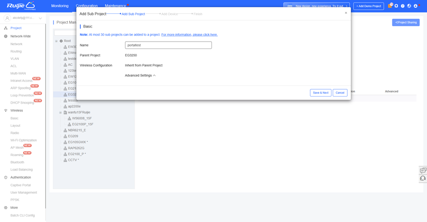

1. Create sub-project

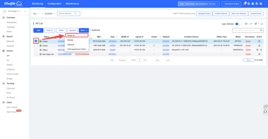

2. Move the specified AP to sub-project

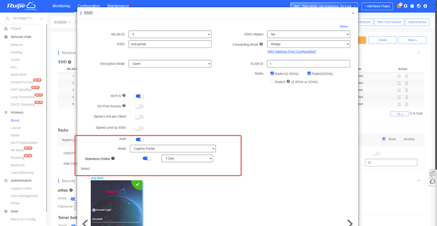

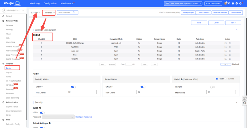

3. Then create the SSID of the portal in the sub-project. After the configuration is completed, only the AP in the sub-project will broadcast the SSID of the portal.
