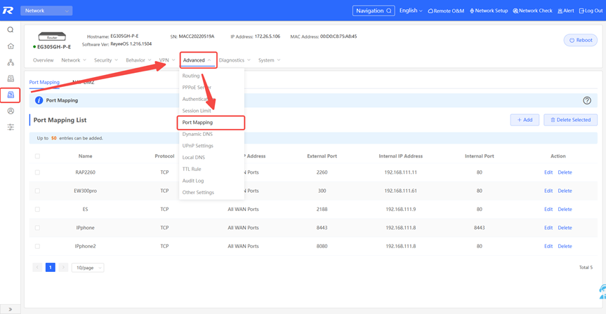

Select Gateway > Advanced > Port mapping

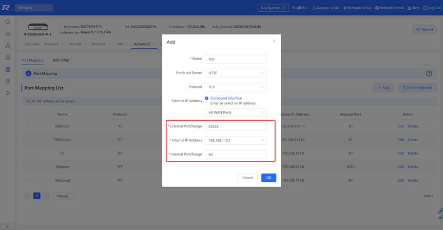

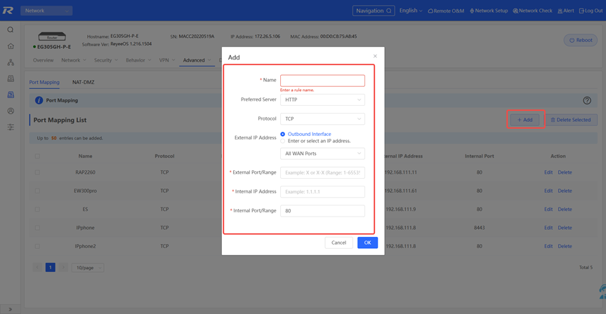

Click Add and then set the internal address、internal port 、External port and Name
Example

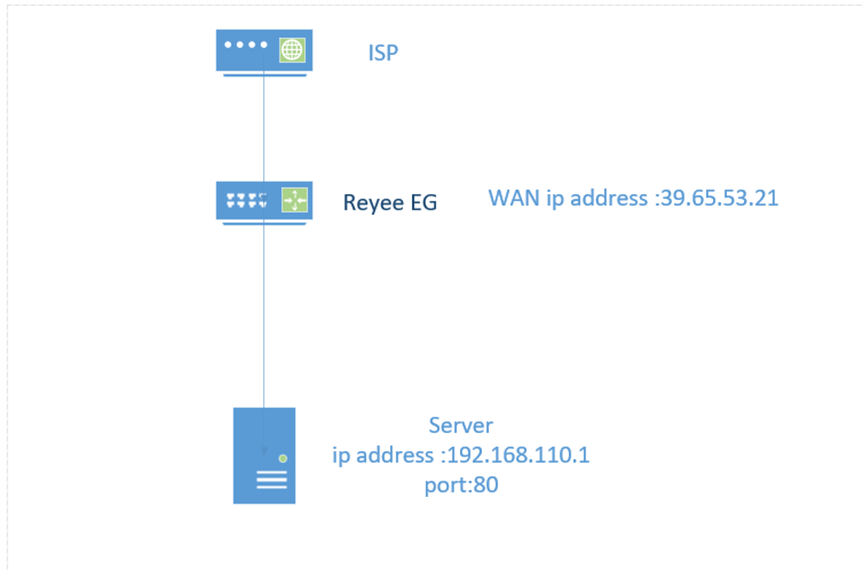

If the user wants to access the server's port 80from the public network, the following configuration is required on the EG
After that, you can access port 80 of the server through 39.65.53.21:80
Note: There are no restrictions on the choice of external Port, the range is 1-65535
