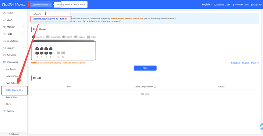

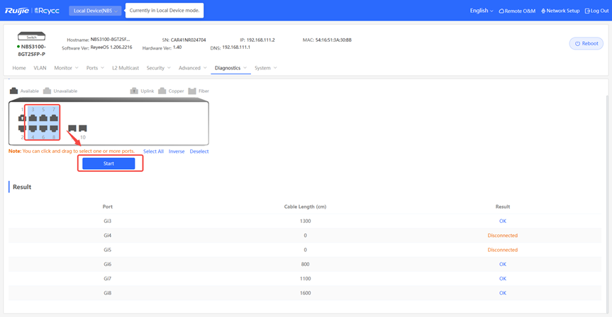

1. Click Local Device>Diagnotics>CableDiagnotics
2. Select port and then click Start
