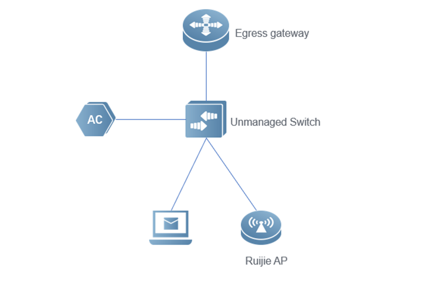

Requirements:
The AC is connected to a non-managed switch and a fit AP connect switch. Users connected to the SSID of this fit AP must be able to obtain an address and access the Internet.
Configuration tips:

Topology:

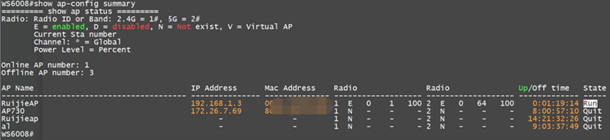

Verification:
Ruijie#show ap-config summary
Ruijie#show ap-config client
