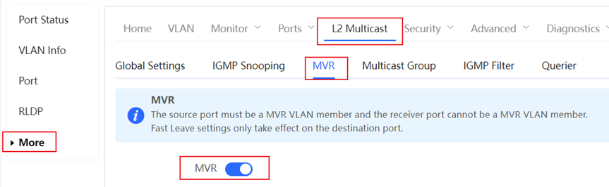

1). Login to the eweb of Reyee NBS switch, and enter the MVR page via this path:
[More] > [L2 Multicast] > [MVR], enable the MVR function.

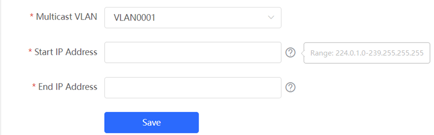

2). Input the parameters: Multicast VLAN, Start IP Address, End IP Address. Click Save.

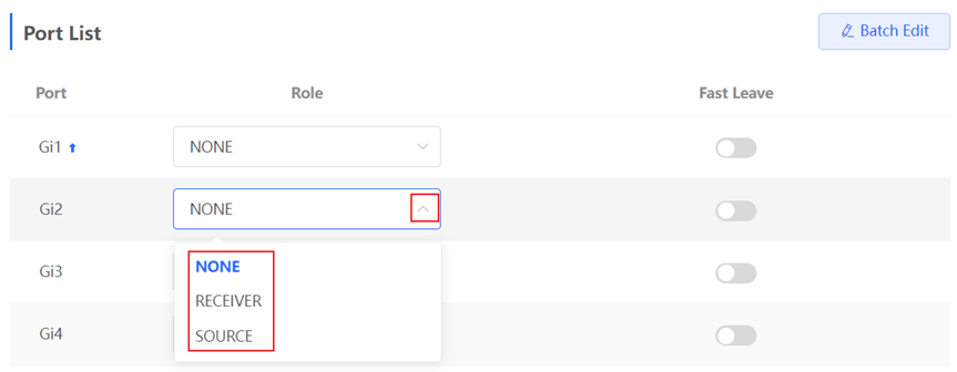

3). Configure MVR ports by editing the port roles.
Receiver: ① receives multicast data streams. ② must belong to MVR VLAN. ③ fast leave takes effect.
Source: ① connected to a client. ② can not belong to MVR VLAN.
