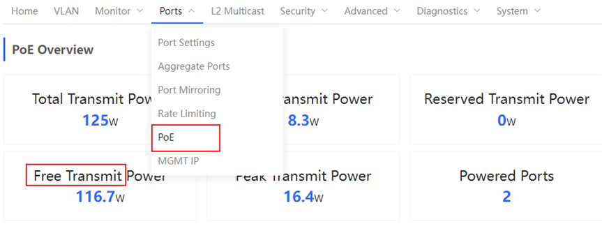

2). Check if the PoE Transit Power is enough on the Reyee NBS switch.
