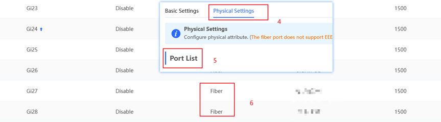

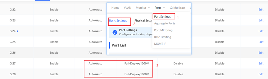

2). Login to the Reyee NBS switch, and check the physical port settings to see whether it is the same as the peer end. Including this: duplex mode, port rate, and attribute.
