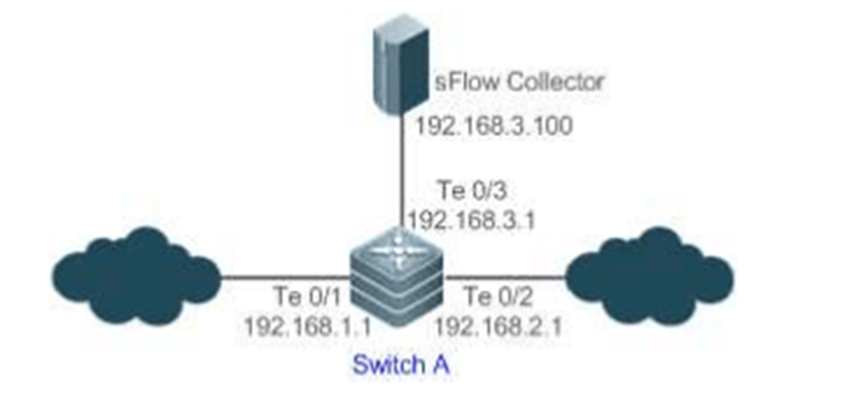

As shown in the topology, SwitchA, as the sFlow Agent, enables flow sampling and counter sampling on port Te0/1 to monitor the traffic in network segment 192.168.1.0 and periodically encapsulate the sampling results into sFlow packets. Sent to the sFlow Collector for analyzing the traffic monitored by sFlow Agent
Topology:
Configuration tips:
1.        Set the sFlow Agent address to 192.168.1.1.
2.        Set the address of the sFlow Collector 1 to 192.168.3.100 and port number is 6343.
3.        Configure flow sampling and counter sampling output to sFlow Collector 1 on interface TenGigabitEthernet 0/1, and enable the sFlow sampling function on this interface

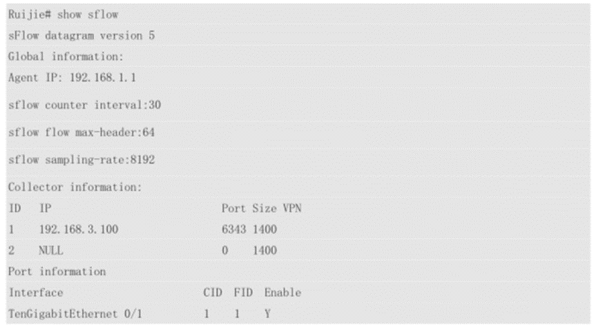

Verification:
Command: show sflow

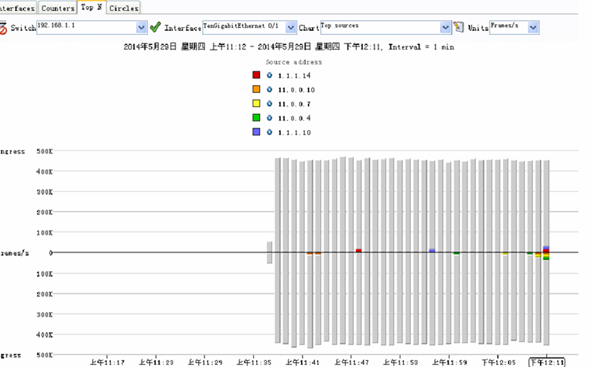

The preceding figure shows the Top N page of the sFlowTrend software. This page displays the flow sampling results and displays the top 5 source IP addresses that involve the largest traffic. The total incoming traffic is about 450 Kpps and the total outgoing traffic is 450 Kpps, which are consistent with the actual traffic.

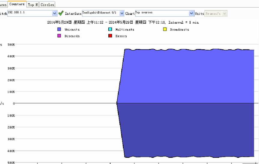

The preceding figure shows the counters page of the sFlowTrend software. This page displays the counter sampling results. The incoming traffic is 450 Kpps and the outgoing traffic is also 450 Kpps. In addition, all packets are unicast packets.
