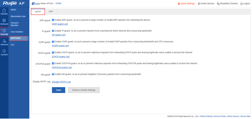

How to configure Anti-attack / NFPP on Ruijie Series AP?
1.        ARP-guard: Enables ARP-guard configuration. Click the ARP-guard Listlink to view the host where ARP attack is detected.
2.        IP-guard: Enables IP-guard configuration. Click the IP-guard Listlink to view the host where IP scanning is detected.
3.        ICMP-guard: Enables ICMP-guard configuration. Click the ICMP-guard Listlink to view the host where an ICMP attack is detected
4.        DHCP-guard: Enables DHCP-guard configuration. Click the DHCP-guard Listlink to view the host where a DHCPv4 attack is detected
5.        DHCPv6-guard: Enables DHCPv6-guard configuration. Click the DHCPv6-guard Listlink to view the host where a DHCPv6 attack is detected.
6.        ND-guard: Enables ND-guard configuration
