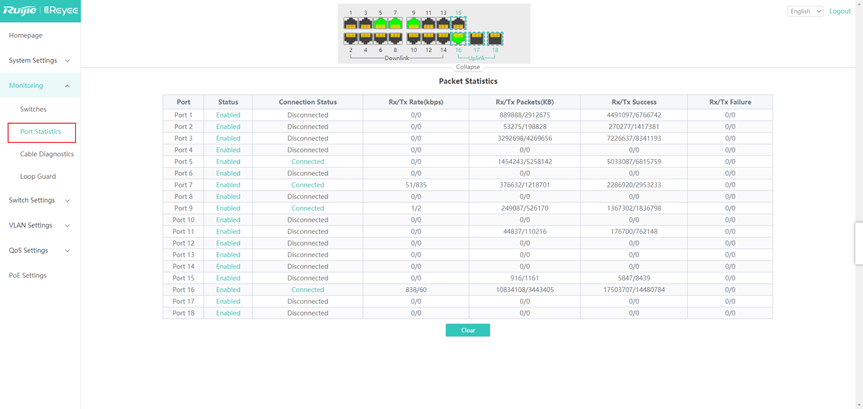

How to check port statistics on the ES switch? Reply
3037 0 2023-8-7 09:41:37
Choose Monitoring> Port Statistics
Note: After clicking Clear, the Port Statistics will be recorded again.
RG-ES208GC
Configuration Switch
