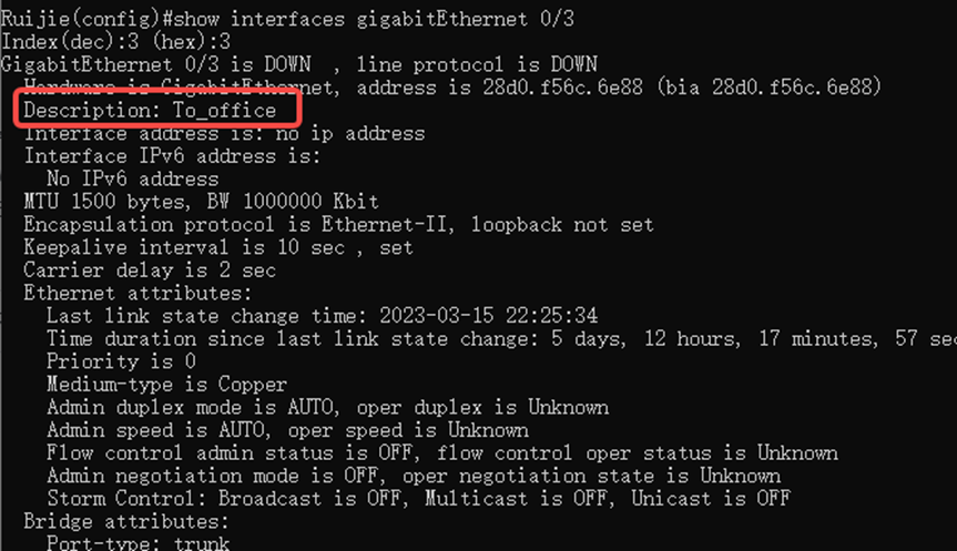

You can add it according to the following command
Ruijie(config)#interface gigabitEthernet 0/3
Ruijie(config-if-GigabitEthernet 0/3)#description To_office
RG-S5300-48GT4XS-E
Configuration Switch
