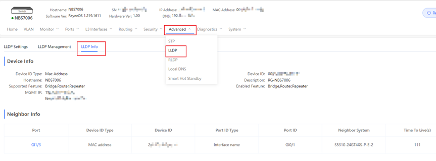

How to check LLDP neighbor on RG-NBS7006 switch? Reply
4703 0 2023-8-7 13:45:45
You can check LLDP neighbor's info on RG-NBS7006 switch in this page:
[Advanced] > [LLDP] > [LLDP Info]
