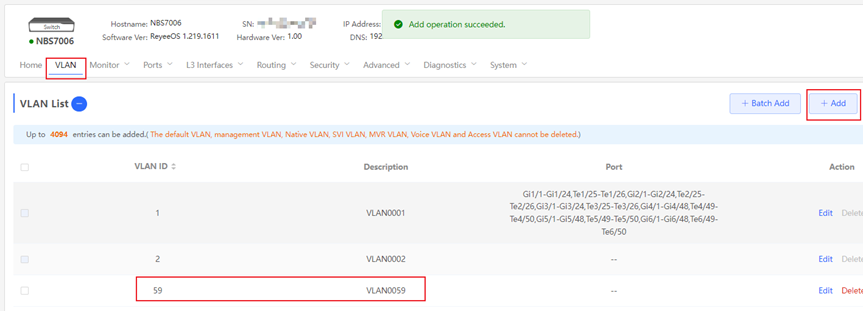

1. log in to the eweb of NBS7006 switch, enter the VLAN page, and click on Add button to create a VLAN first.

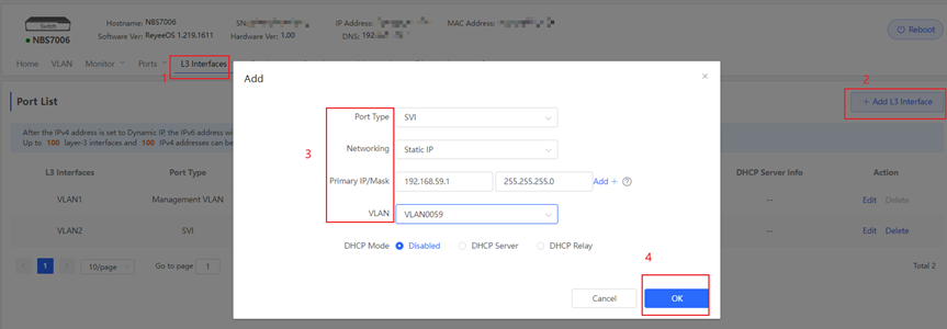

2. Enter the L3 Interfaces page, click Add button, choose SVI as the port type, input the relevant parameters, and click OK.
