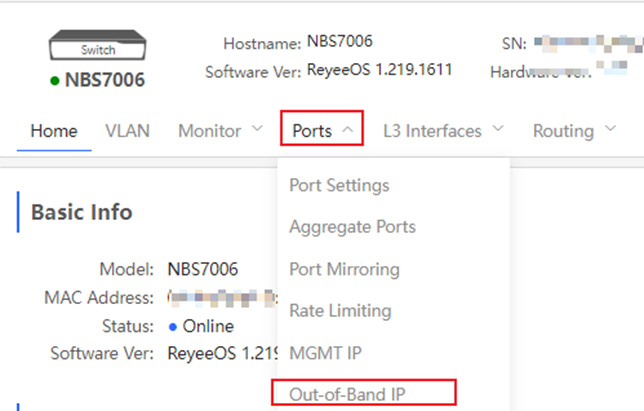

You can follow these steps to configure Out-of-Band IP on RG-NBS7006 switch:
1.Login to the eweb of NBS7006 switch, and enter this page: [Ports] > [Out-of-Band IP]

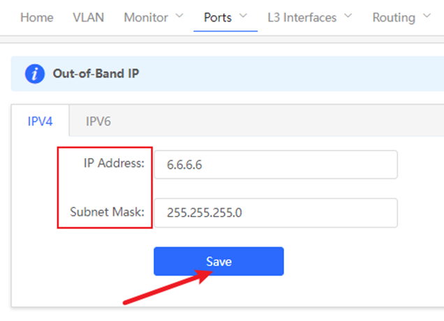

2.After that, you can set an IP address on this page. By default, it is empty.
