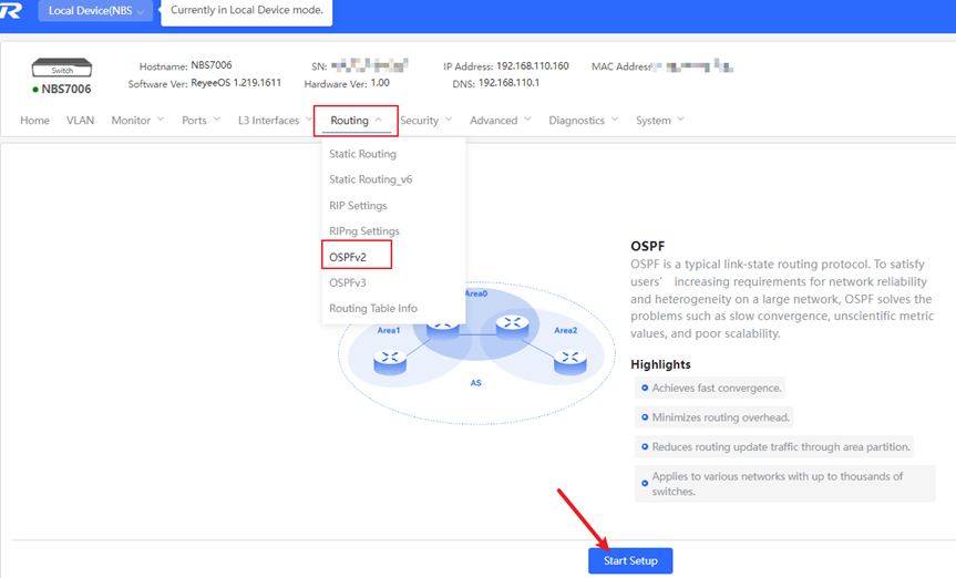

1.Login to the eweb of NBS7006 switch, enter this page: [Routing] > [OSPFv2] , click Start Setup button

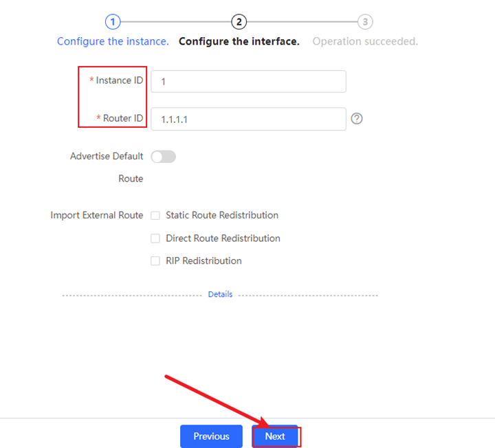

2.Configure the Instance ID and Router ID on the first page.
If you want to advertise the default route or import other external routes, you can choose the parameter as you wish.
If not, click on the Next button and move to the next page.

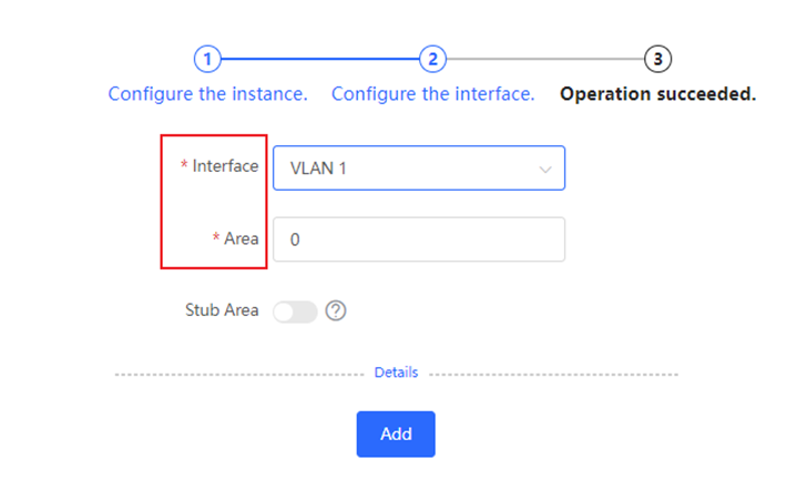

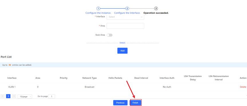

3. Choose the interface that you want to be advertised by OSPF. Create Area 0. Click on the Add button.

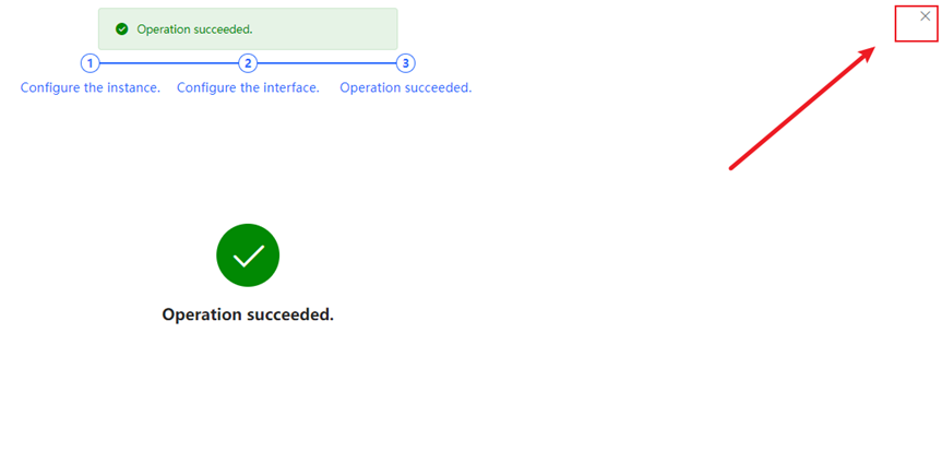

4.Click on the Finish button to complete the OSPFv2 configuration on RG-NBS7006 switch.
