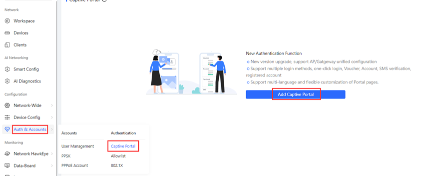

How to configure captive portal for NBR on the New Cloud? Reply
5917 2 2023-8-7 14:04:32

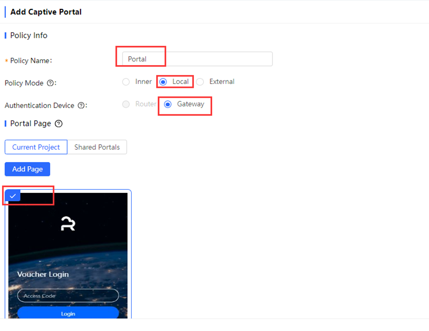

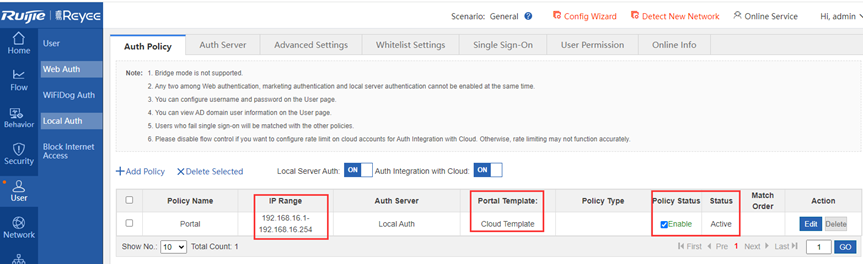

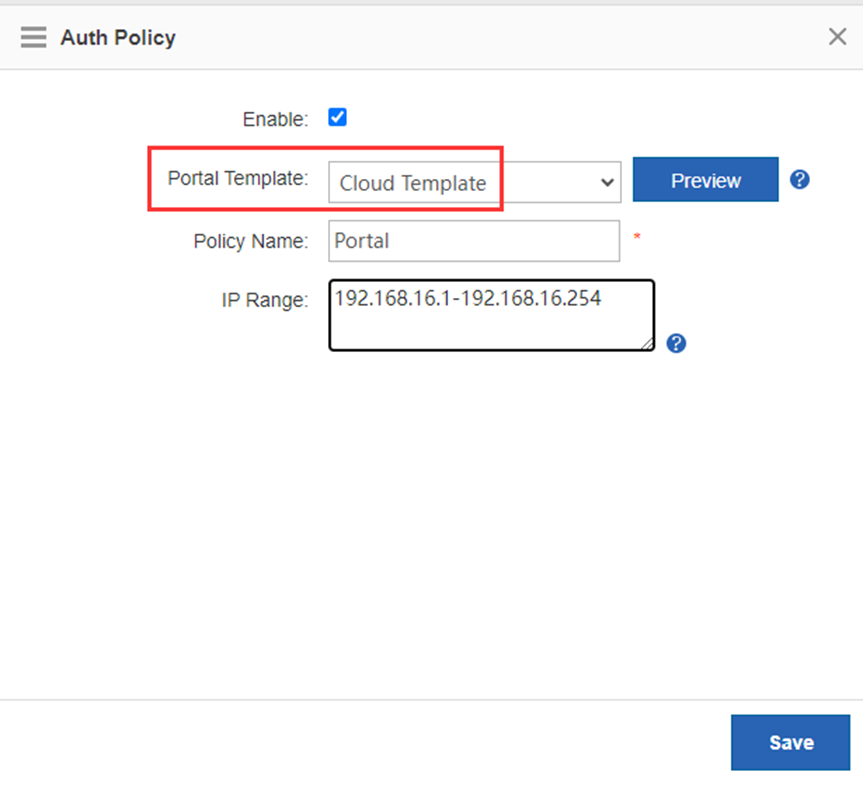

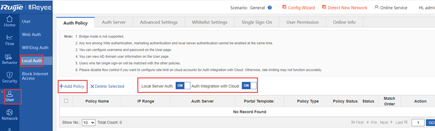

1. Configure portal policy with local mode
2.Login to the web interface of the NBR and configure corresponding ip range for portal

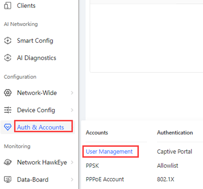

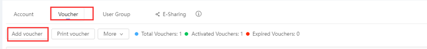

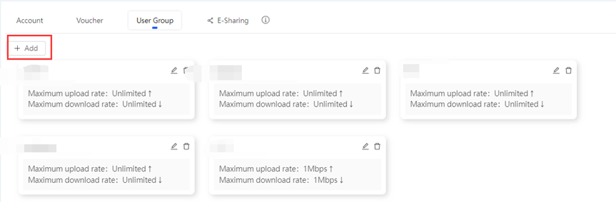

3.Configure voucher code on the Cloud

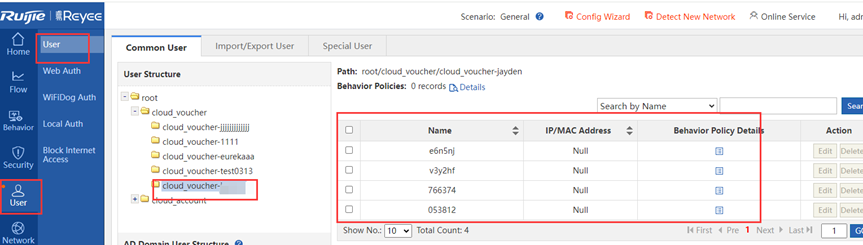

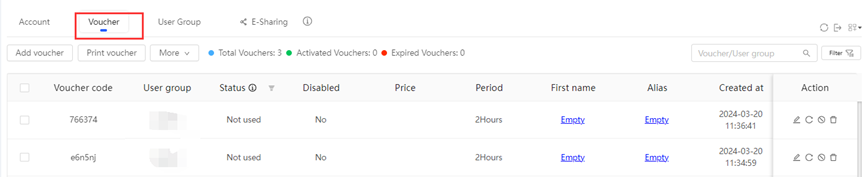

4. Check that the voucher code is successfully synchronized in the user list of the NBR.
Generally, it takes a few minutes forthe voucher information to be synchronized successfully

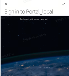

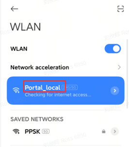

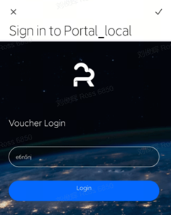

5.Connect to the Portal SSID, and input the corresponding voucher code that was created on the Cloud
