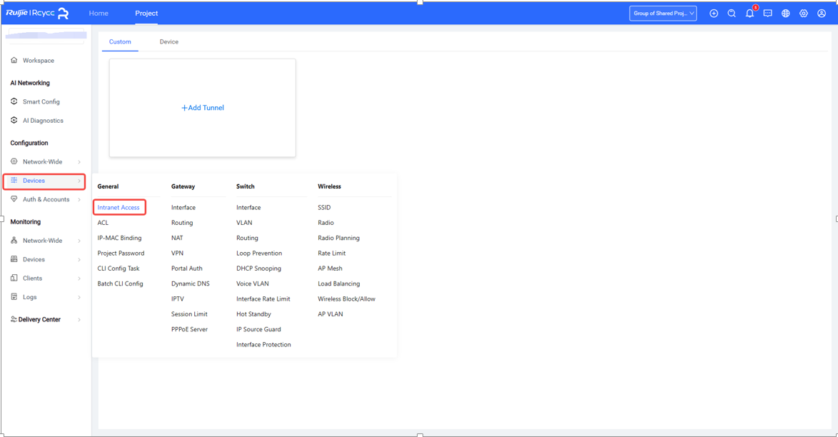

1.Select Project--->Devices--->Intranet Access

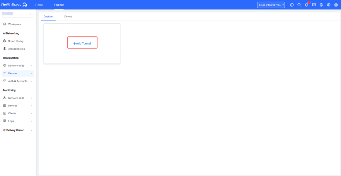

2.Click +Add Tunnel

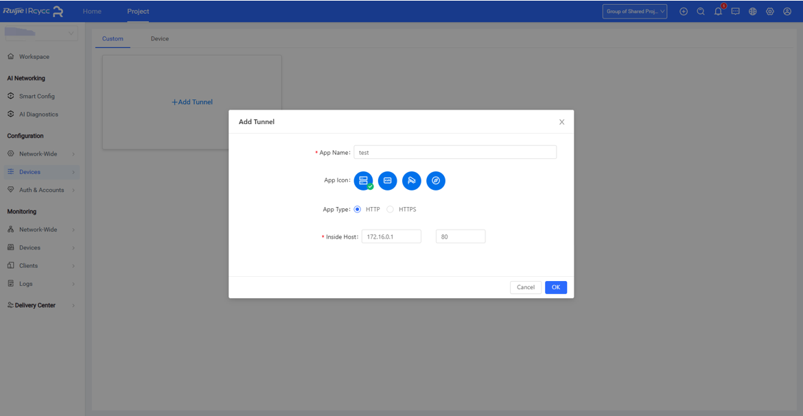

3. Configure the tunnel name, icon, type, intranet address, and port number of the device that needs to create the tunnel

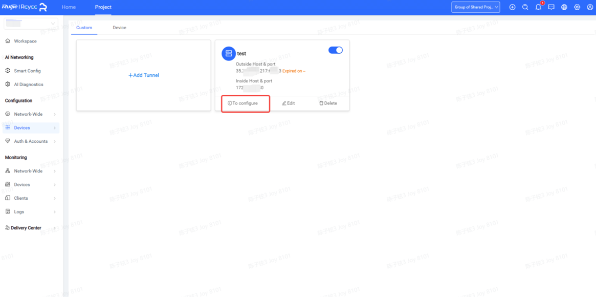

4. Then you can click 'To configure ' to access the device
