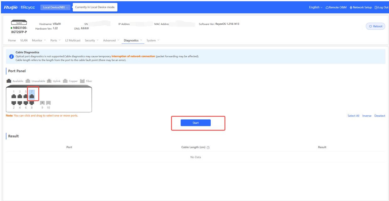

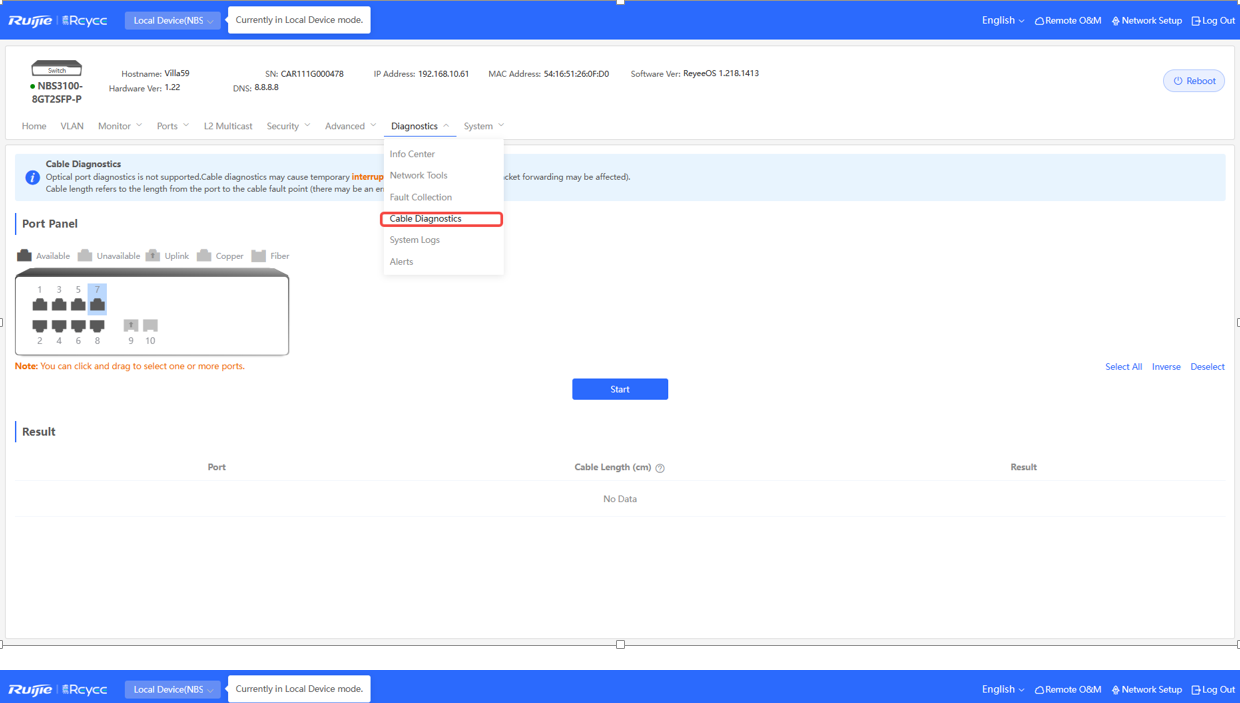

You can check it according to the following steps
1. Go to the device's local web interface
2. Click Diagnostics, Select the interface to be detected, and click "Start".
