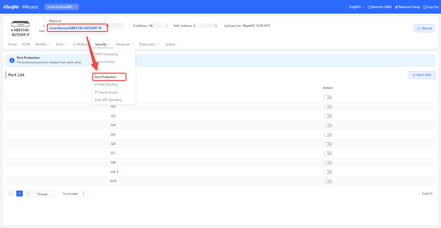

You can configure it according to the following steps
Select device local web interface--->Security--->Port Protection

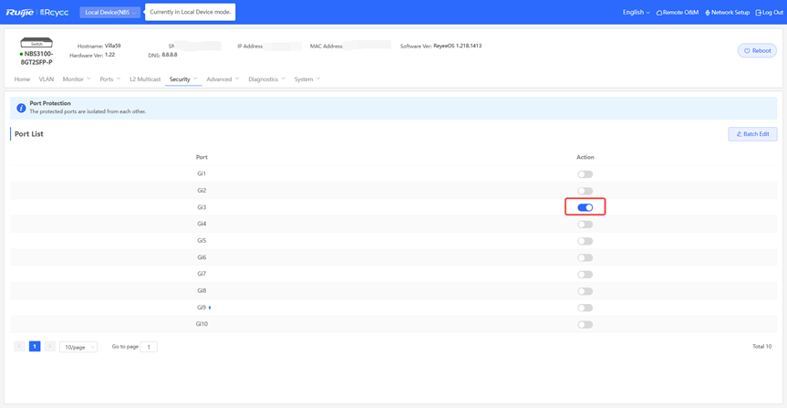

Select the interface you want to configure the port protection. After configuration, the protection interface and the protection interface can not communicate with each other.
