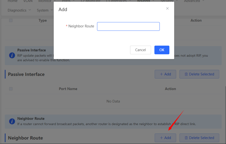

You can click [Local Device] > [Routing]> [RIP Settings] > [Advanced], Click [Add], and enter the IP address of the neighbor router.
Note: When the router can not process broadcast packets, another router can be designated as the neighbor to establish a RIP direct link.
