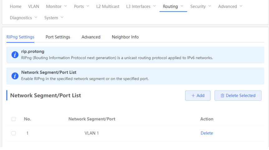

You can Click [Device]> [Routing]> [RIPng Settings] > [RIPng Settings]

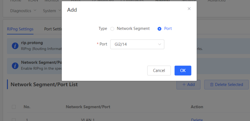

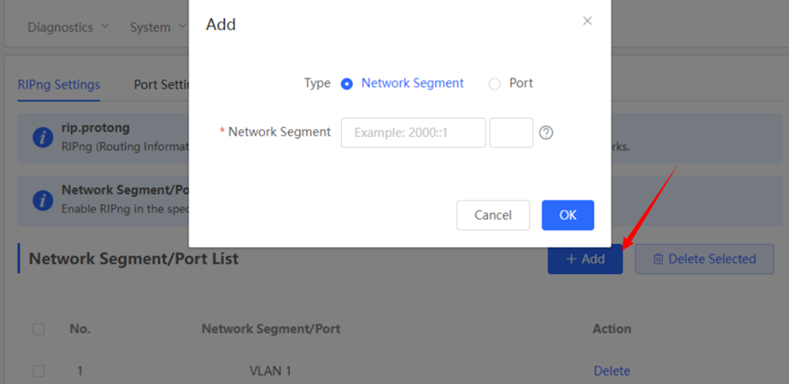

Click [Add], set Type to Network Segment or Port, and specify the network segment or port accordingly
Type:
Network Segment: Enable RIP in the specified network segment. The IP addresses of this network segment are added to the RIP routing table, and the device and its RIP-enabled neighbor devices learn the routing table from each other.
Port: Enable RIP on the specified port. All the IP addresses of this port are added to the RIP routing table, and the device and its RIP-enabled neighboring devices learn the routing table from each other.
Network Segment: Enter the IPv6 address and prefix length when the Type is set to Network Segment. RIPng will be enabled on all interfaces of the device covered by this network segment.
Port: Select a VLAN interface or physical port when Type is set to Port.
