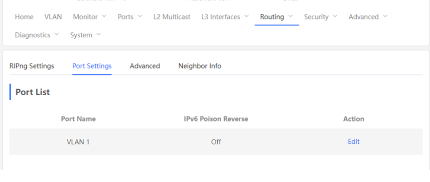

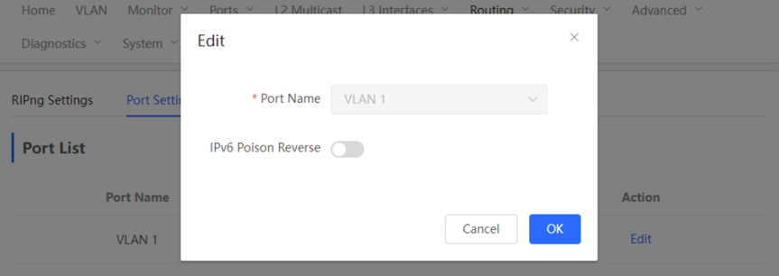

You can Click [Device]> [Routing]> [RIPng Settings] > [Port Settings], Click [Edit], and enable IPv6 poison reverse.
Poison reverse: When a device learns a route to a network from an interface, it advertises an unreachable route to the network through the interface. That you told me once, then I told you, you don't need to tell me again, avoid the loop
