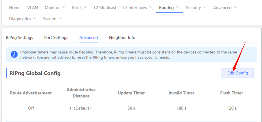

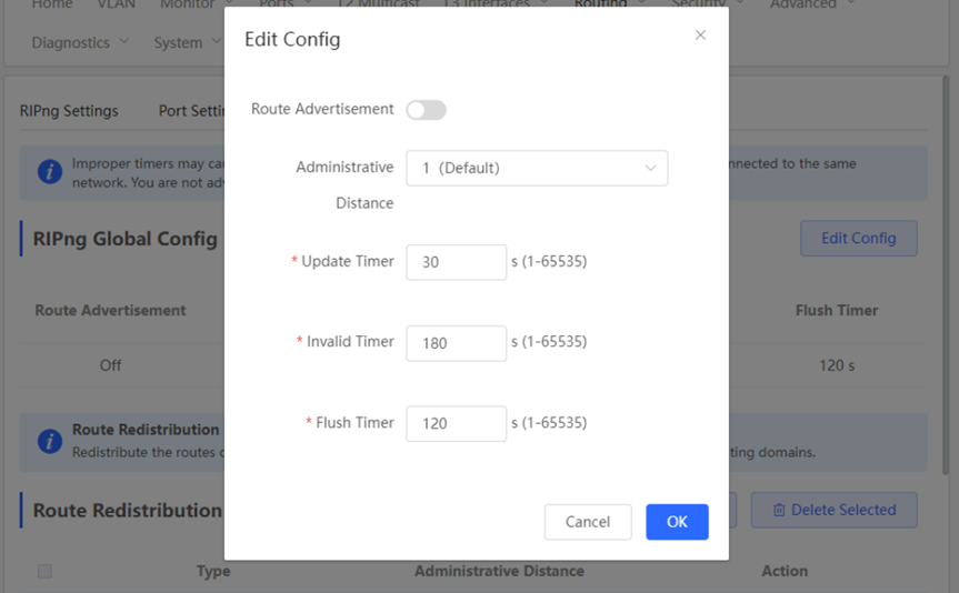

1. Configuring the RIPng Global Configuration
You can Click [Device]> [Routing]> [RIPng Settings] > [Advanced], Click [Edit Config]
Route Advertisement: After route advertisement is enabled, the current device generates a default route and sends it to the neighbor.
Administrative Distance: Redistribute routes of other protocols to the RIP domain so that RIP can interwork with other routing domains.
Update Timer: RIP update cycle. The routing information is updated every 30 seconds by default.
Invalid Timer: If no update is received before a route becomes invalid, the route is considered unreachable. The default value is 180 seconds.
Flush Timer: If no update is received before the flush timer of an invalid route expires, the route is completely deleted from the RIP routing table. The default value is 120 seconds.

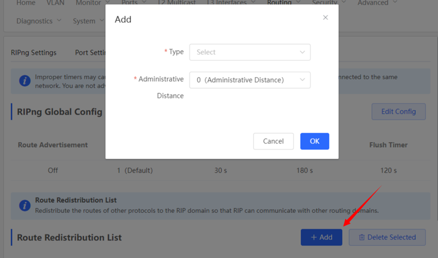

2. Configuring the RIPng Route Redistribution List
You can Click [Device]> [Routing]> [RIPng Settings] > [Advanced], Click [Add]
Type: Direct Routing/ OSPF Routing/ Static Routing
Administrative Distance: Value range: 0-16. The default value is 0.

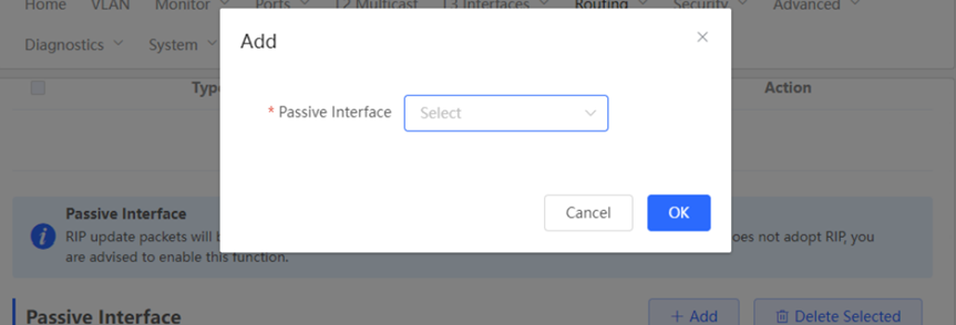

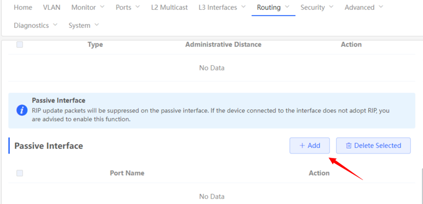

3. Configuring the RIPng Passive Interface
You can Click [Device]> [Routing]> [RIPng Settings] > [Advanced], Click [Add],and enter the IP address of the neighbor router.

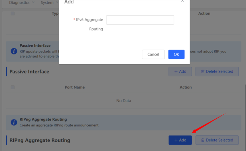

4. Configuring the IPv6 Aggregate Route
You can Click [Device]> [Routing]> [RIPng Settings] > [Advanced], Click [Add]. and enter the IPv6 address and prefix length (value range: 0–128).
