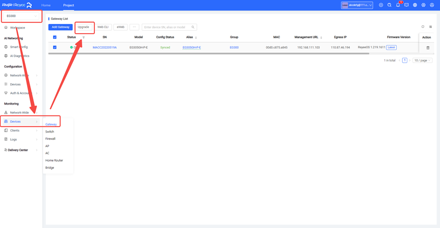

1.        Select project--->Select device --->Click upgrade

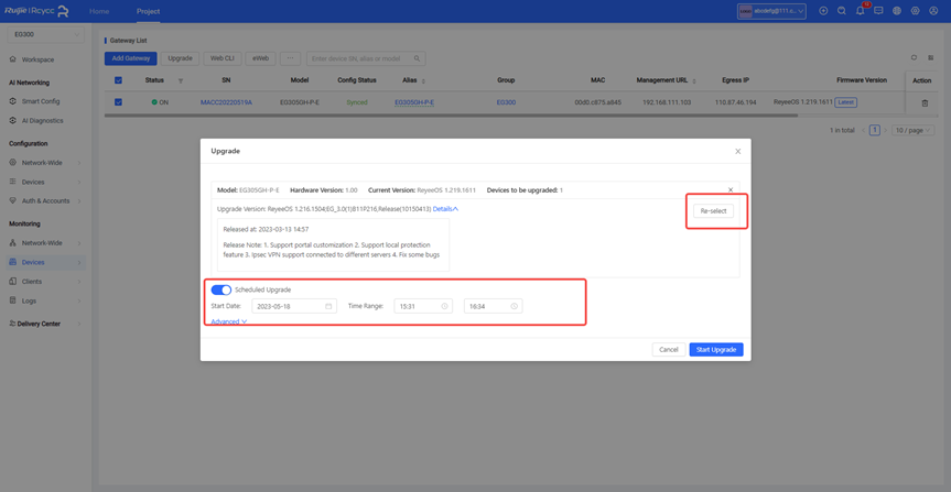

2.        Select firmware and upgrade time then click 'Start Upgrade'

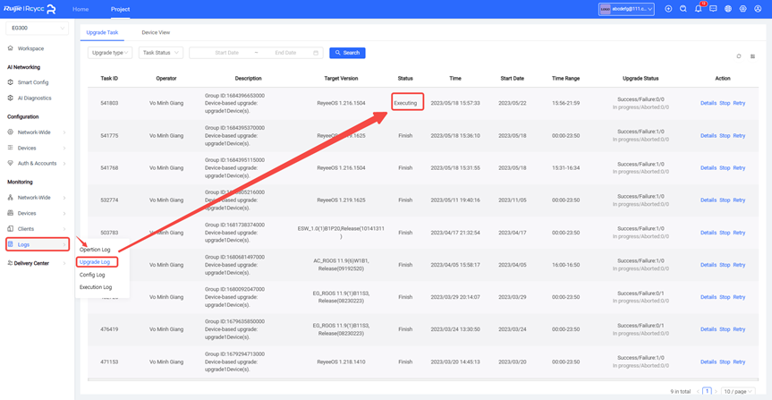

You can check the progress in the 'Upgrade log '.
