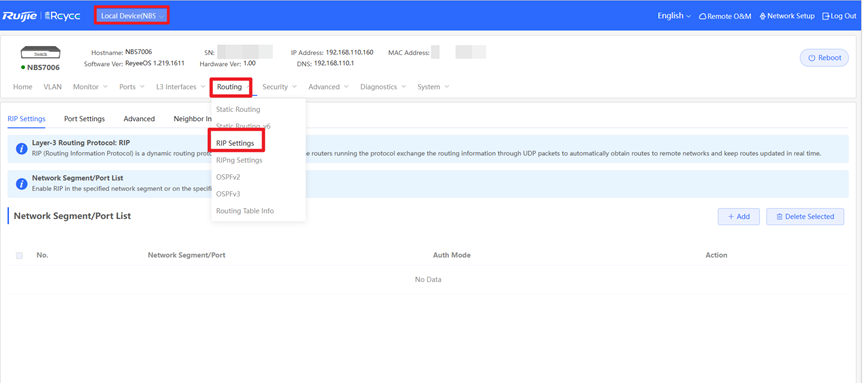

1)Choose Local Device > Routing > RIP Settings.

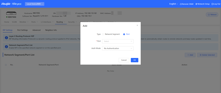

2) Click Add and configure the network segment and interface.
