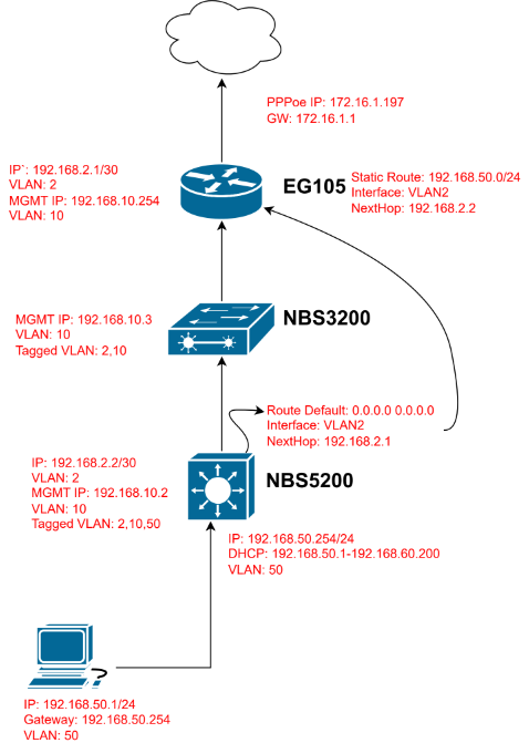

Hi,
How should I configure the Masquerade of an unreachable network in Layer 2 on the EG105 Router?
The networkt that I want to configure the masquerade is 192.168.50.0/24.
My topology;
RG-EG105G V2

Hi,
I need to make sure that the EG105G is masquerade on the 192.168.50.0/24 network.
As you can see in the topology, the 192.168.50.0/24 network has the NBS5200 switch as a gateway and the NBS5200 has a default route forwarding all packets destined for the internet to the eg105G.
In my tests this doesn't work.

To close the topic
My problem was that the NBS5200 had a bug in the routing table that was fixed in version 2.230.
The inssue of masquerade (NAT), I ended up discovering that the EG105 perform NAT from any source to the WAN interface.
