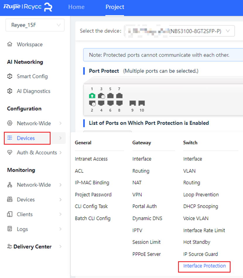

1. log in to Ruijie Cloud, and go to the project where your Reyee Switch is currently in. Click the interface protection button.

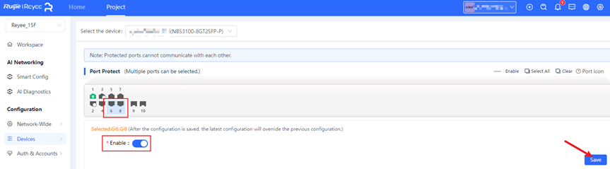

2. Choose the ports that you don't want them to communicate with each other. Click Enable button, and save.

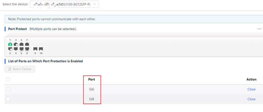

3. You can verify the result on the same page.
