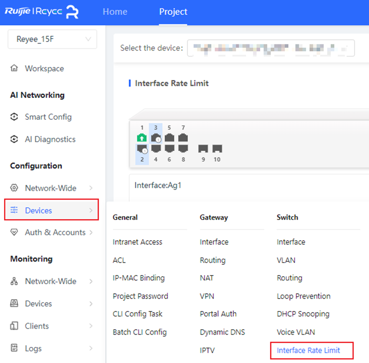

1. log in to Ruijie Cloud, and go to the project where your Ruijie/Reyee Switch is currently in. Click the interface rate limit button.

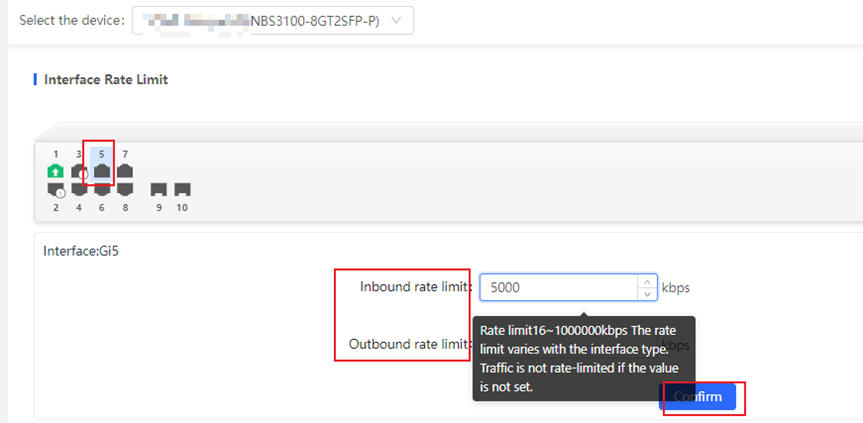

2. Choose the port that you want to set the rate limit, input the value, click confirm button.

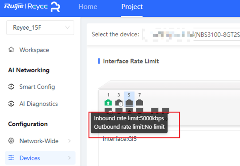

3. You can hover over the port you just configured and see the configuration result:
