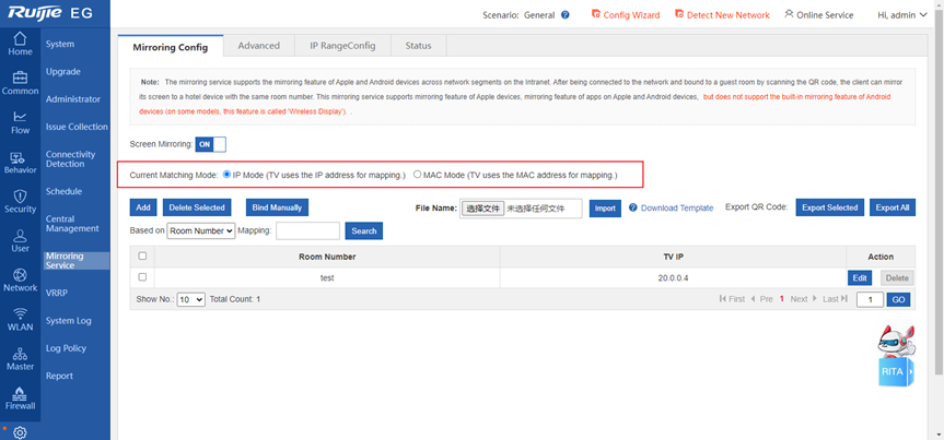

6) if you choose IP Mode, then change it to MAC Mode, the configuration will be cleared.

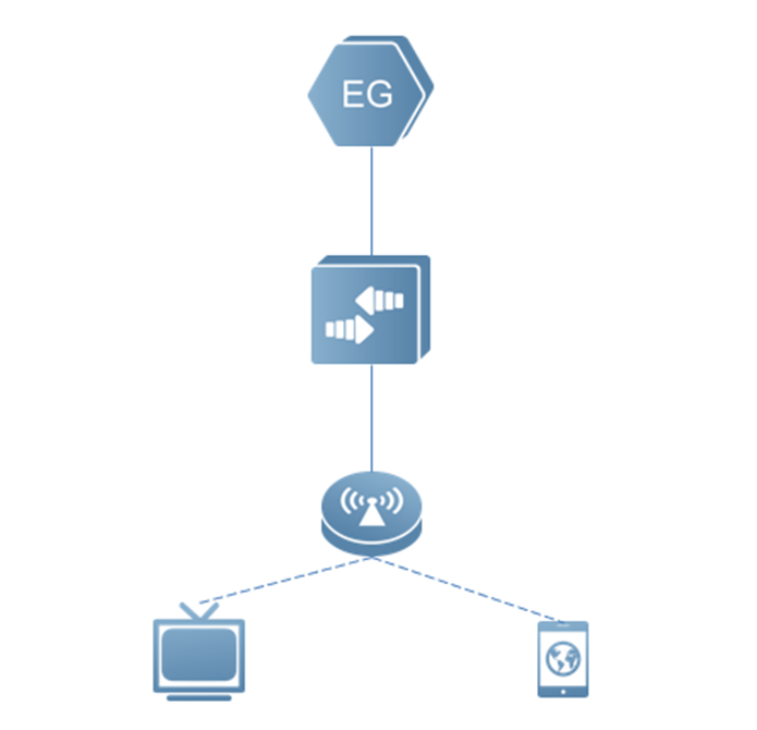

3.        Topology

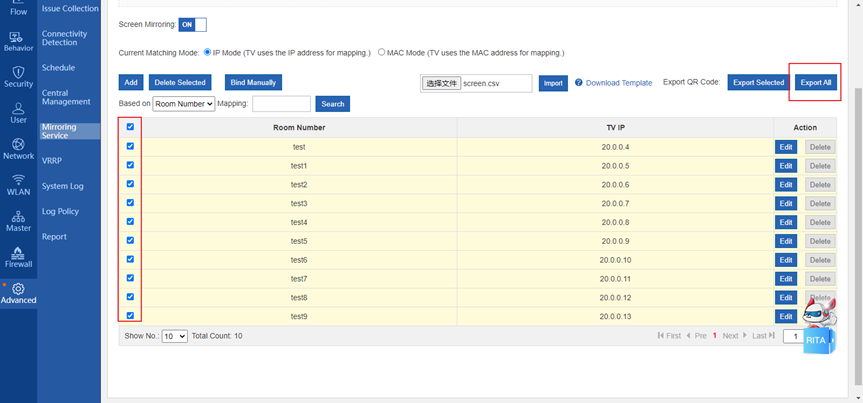

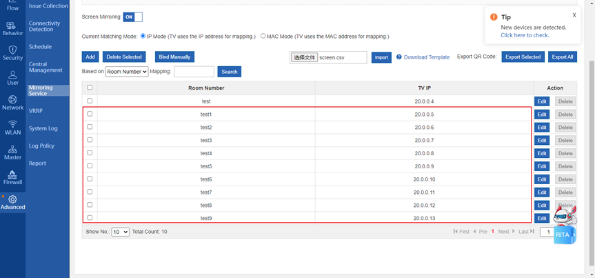

4.        Configure steps

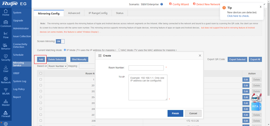

Configure the mapping between the room number and TV:

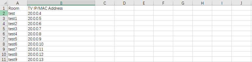

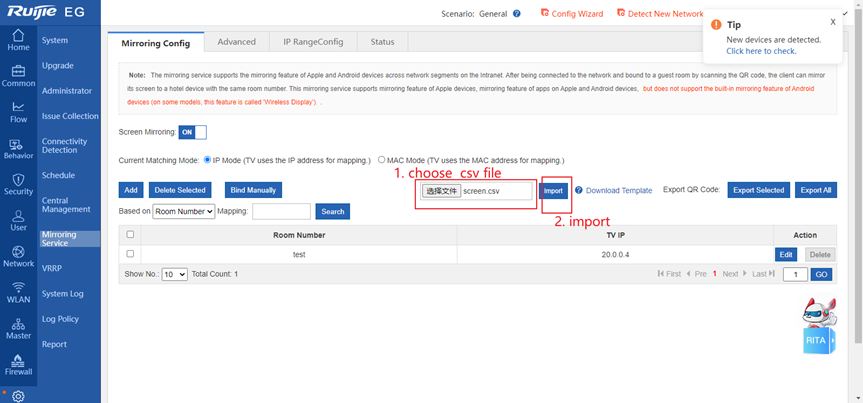

To quickly configure the remaining mappings, export 1 information and modify the exported file.

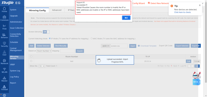

Import files to create mappings in batches:
After the configuration is imported, you can check that the configuration has been imported into the web. If the configuration fails to be imported, a message will be displayed after the import is complete

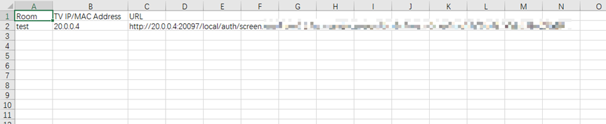

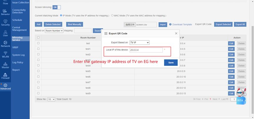

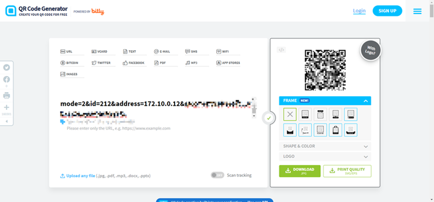

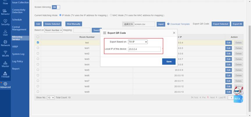

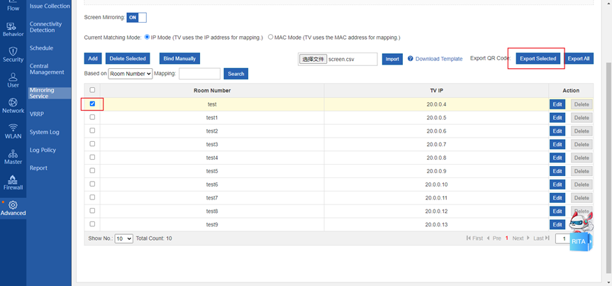

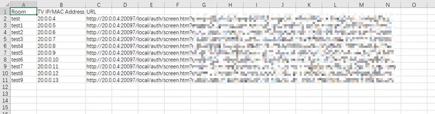

Finally, according to the room number again exported as follows, you can view the url address of each record, and then convert it into two-dimensional code.
Or you can choose export all:
Copy the url and generate a QR code. Then paste it next to the corresponding TV.
